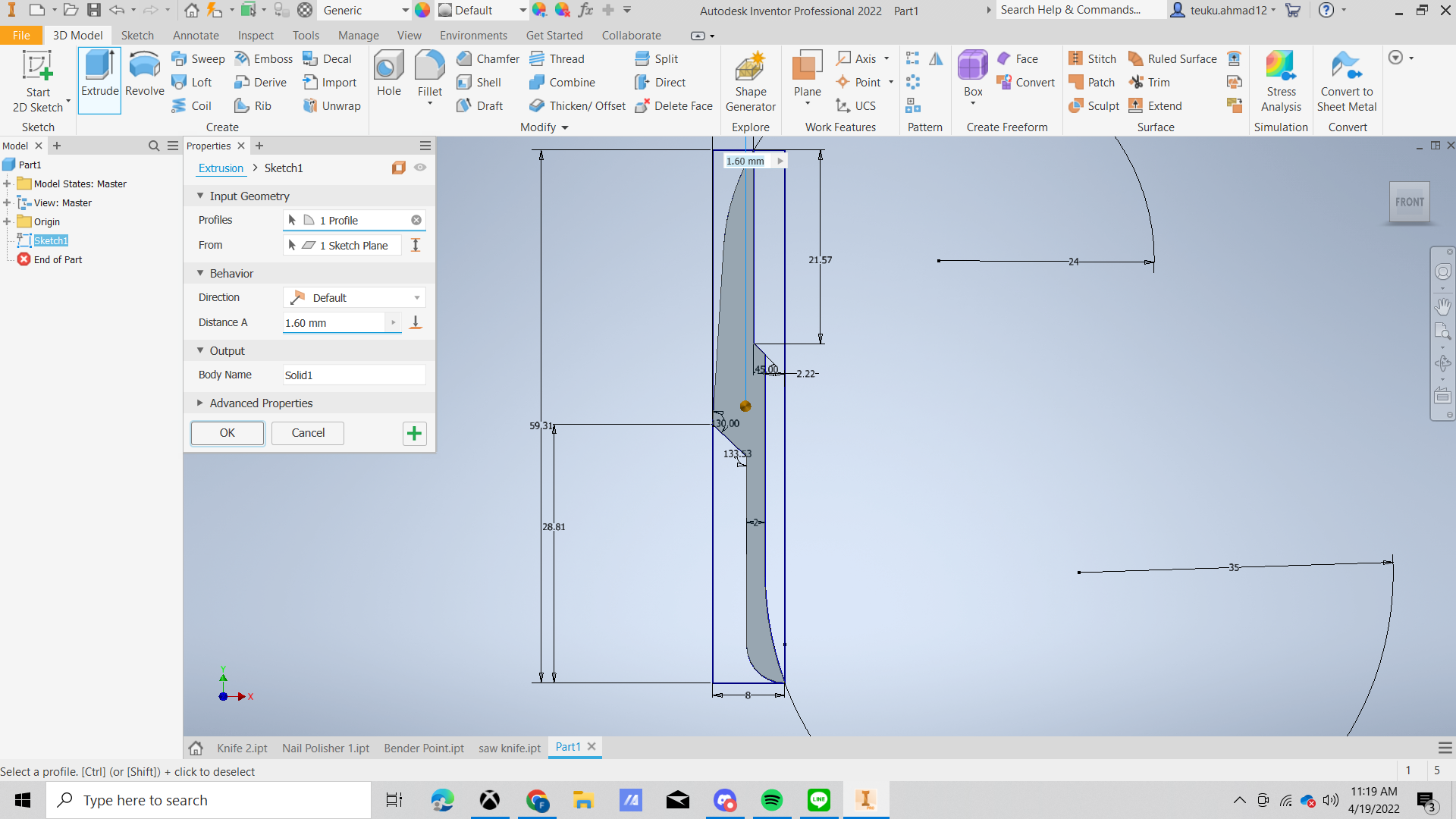

Step 1:
Make a rectangle with height 59.3 mm and the width 8 mm. after that make sketch of scissor like in the picture. draw the line from the bottom make a little curve and the draw a straight line and make corner with angle 133.53 degree and after that draw a straight line again with the end make a little curve with radius 24 mm and the make a straight line to the bottom with length 21.57 mm and make a corner with angle 45 degree and make straight line again with the end make a little curve with radius 35 mm.
Step 2:
Extrude the scissor with the distance is 1.6 mm
Step 3:
Make a circle in the middle of the scissor with diameter 2 mm
Step 4:
Extrude the circle with direction is flipped and the distance is 1.6 mm

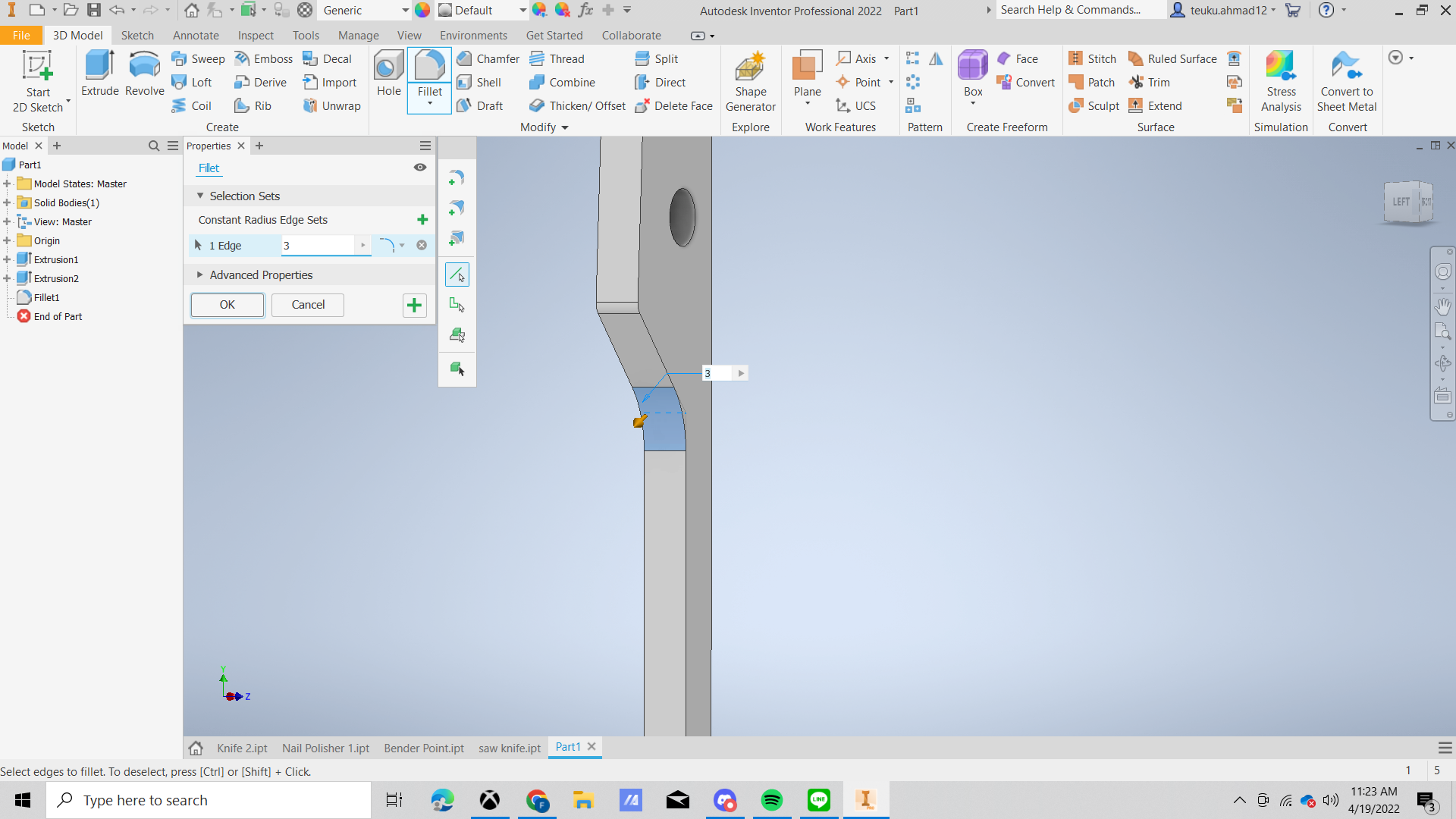

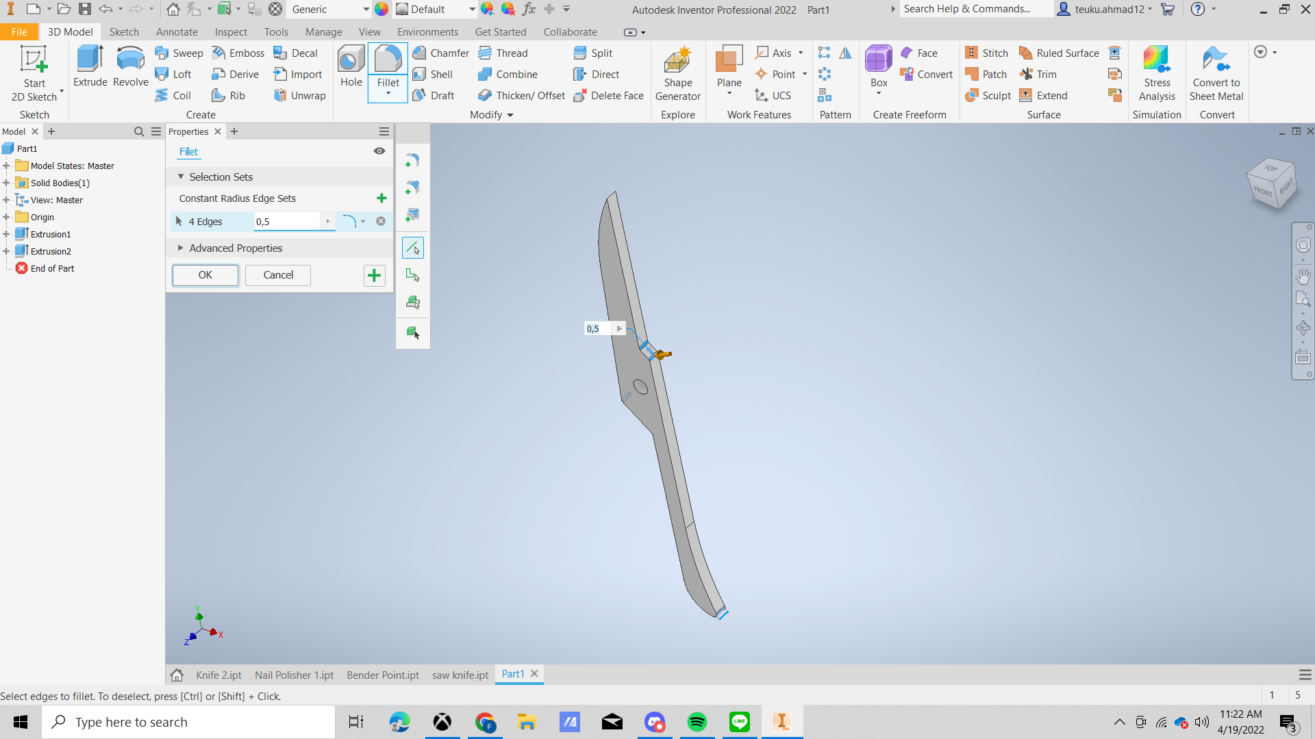

Step 5:
Fillet the edge like in the shown in the picture. in the picture 1 the radius edge is 0,5 mm and the second picture is 3 mm

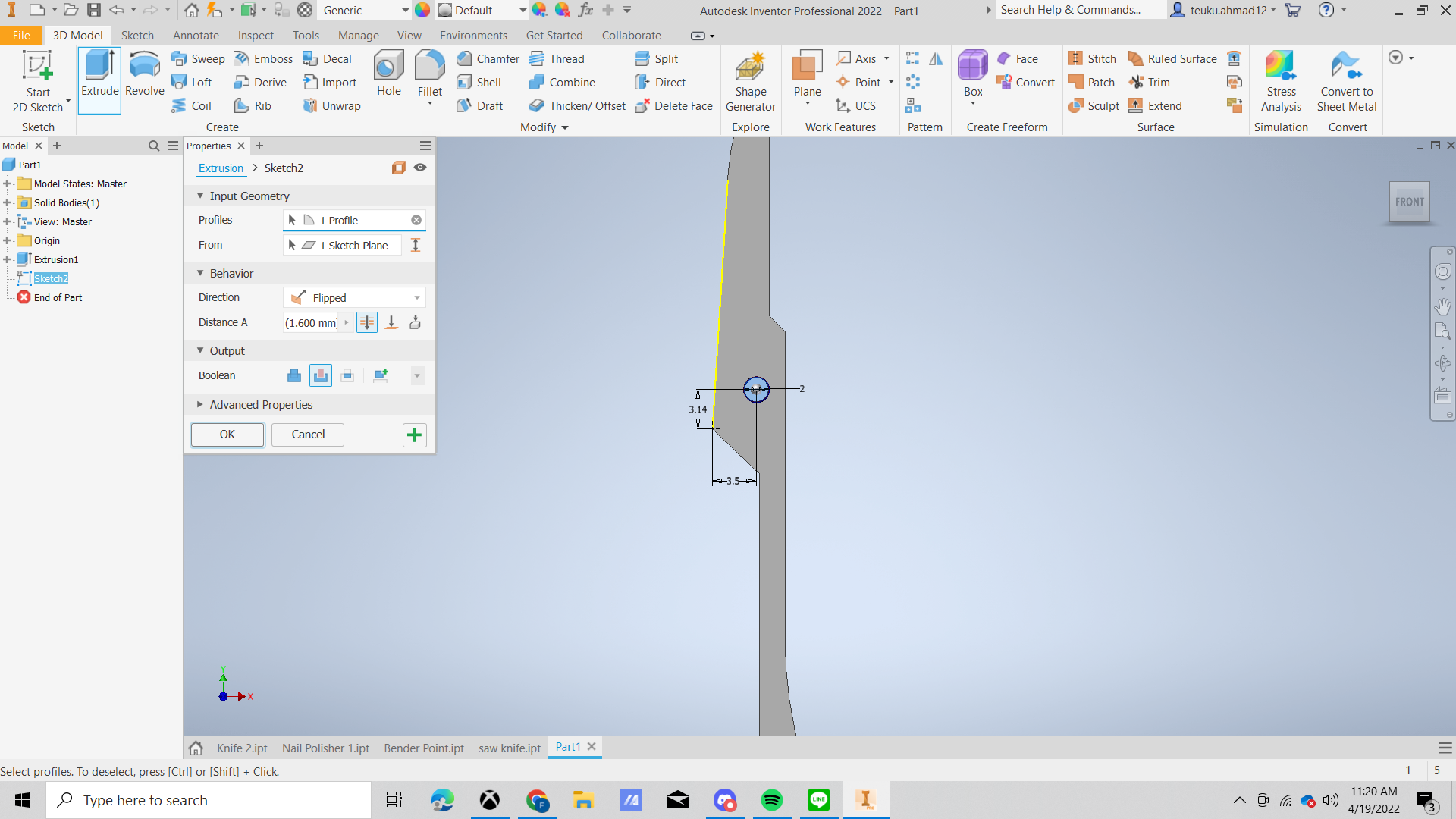

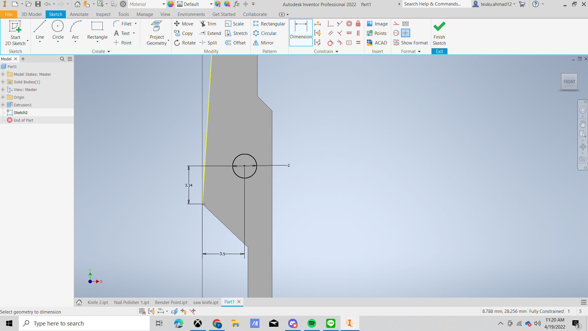

Step 6:
After that draw a sketch like in the picture in the upper part of the scissor arm and than extrude with the direction is flipped and the distance is 0.8 mm

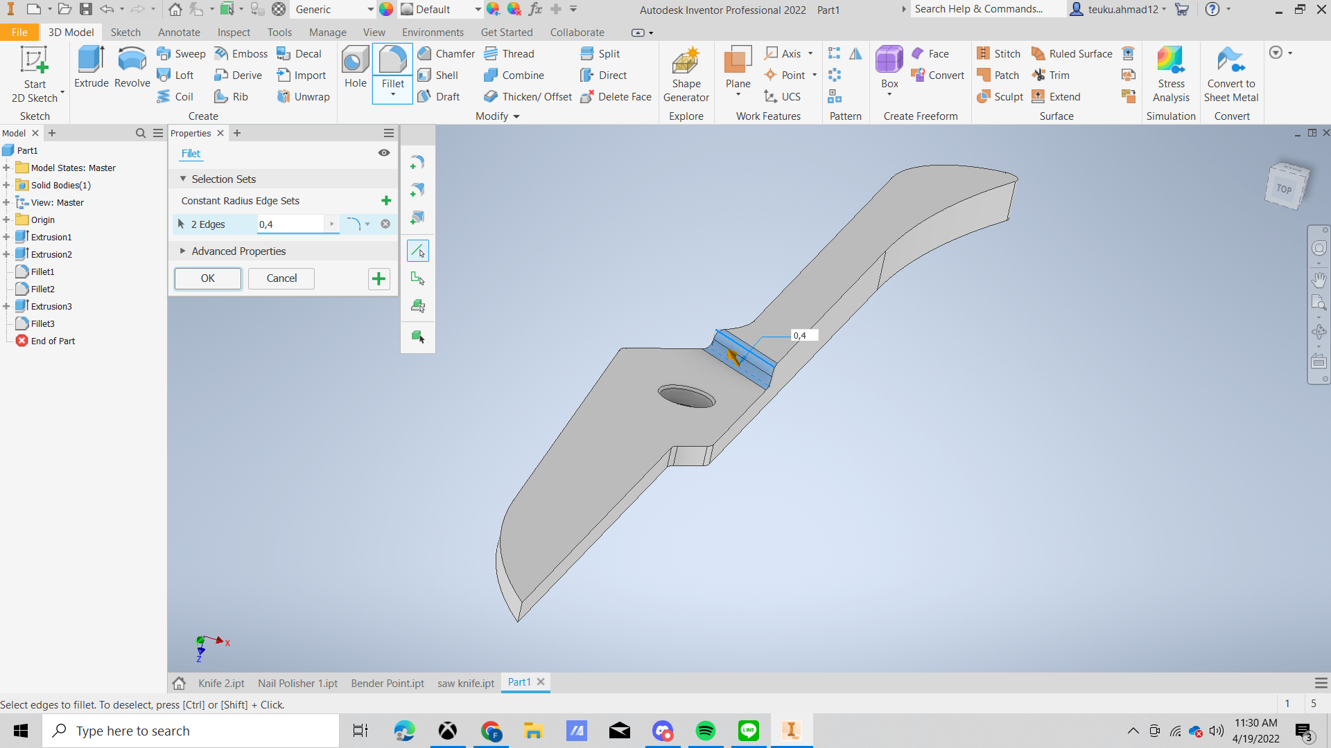

Step 7:
FIllet the edge with the radius edge is 0,4 mm
Step 8:
Fillet the each side of the circle with the radius edge is 0.1 mm

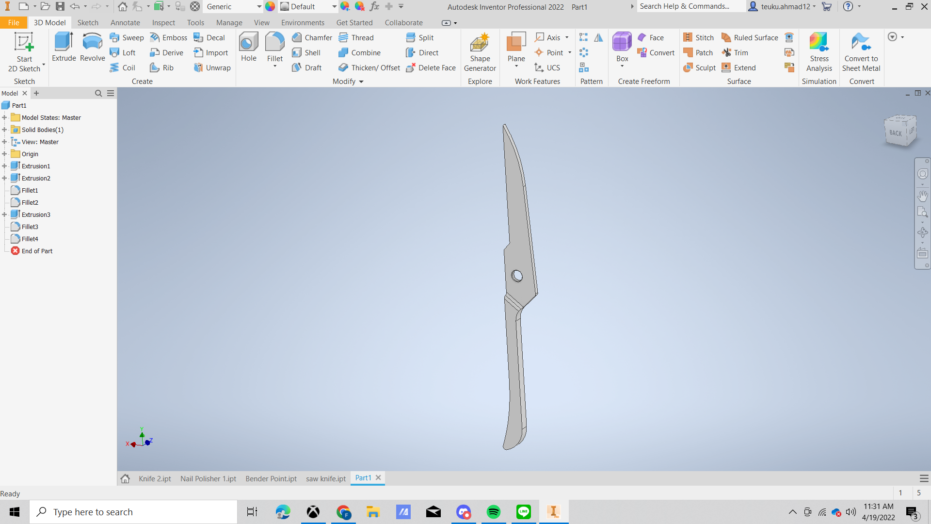

Step 9:
And the scissor arm 1 is done
