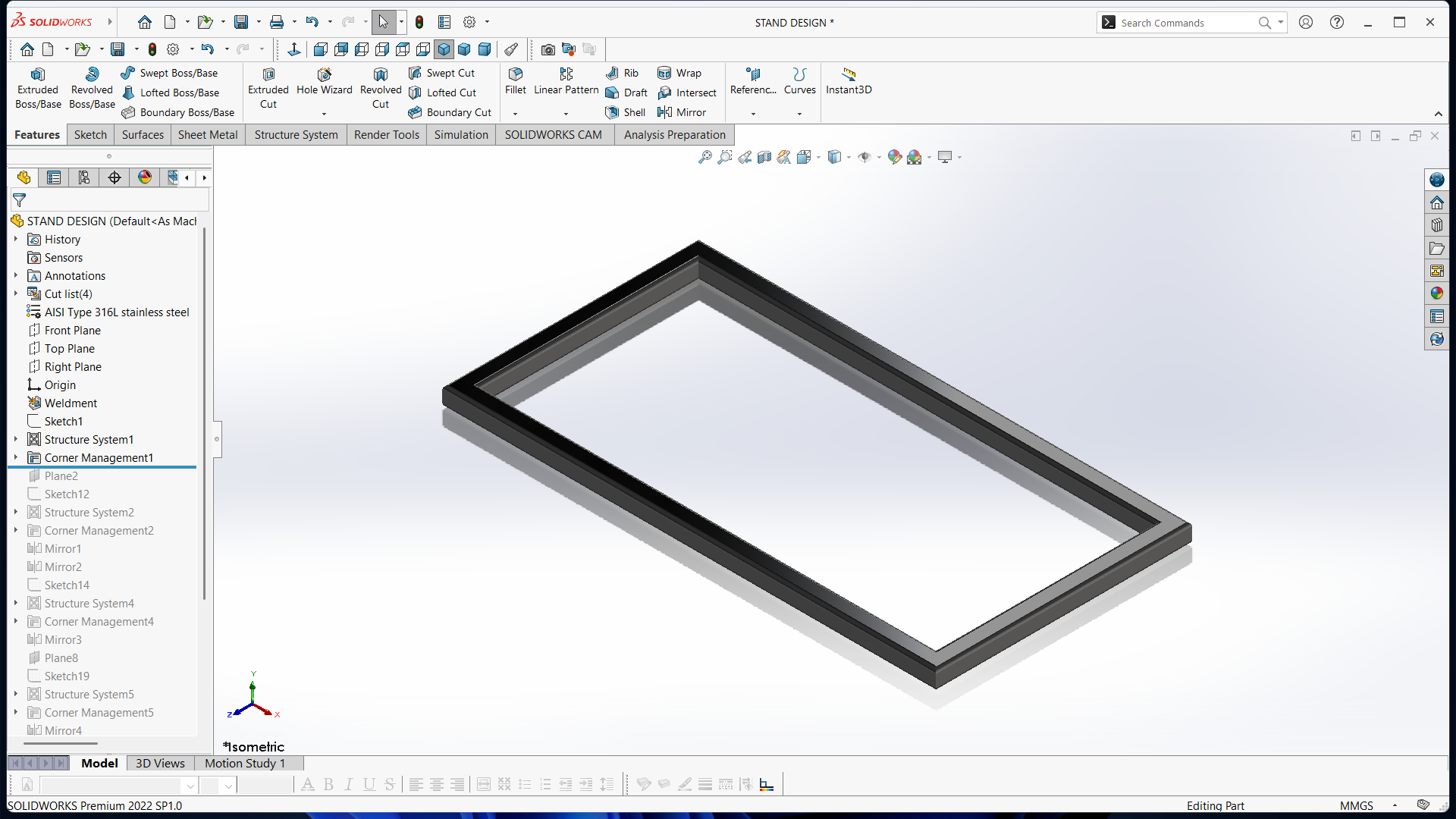

Step 3: 3D Modeling in SOLIDWORKS
Start by creating rectangular hollow sections (RHS) using the Extrude Boss/Base feature.
Assemble the main frame with four vertical legs and base plates using Mate features.
Design the elevated middle section by adding vertical supports and ensuring proper connectivity.
Apply fillets or chamfers to remove sharp edges and improve manufacturability.
