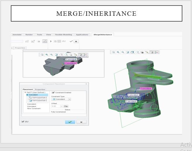

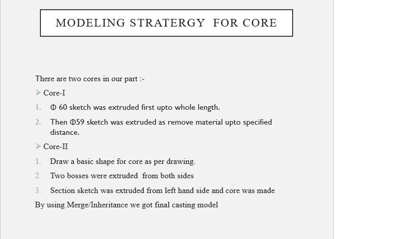

USING PTC-CREO 4.0 WORKING PLATFORM FOR THIS PROJECT.
WE USE MERGE-INHERITANCE/REVOLVE FOR MODELLING PURPOSE.
HERE IS COMPLETE SOLUTION OF PROJECT.(FOR MODEL REFER MODELLING SECTION)

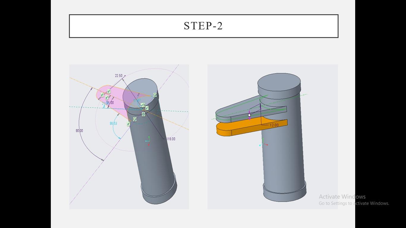

Step 2:

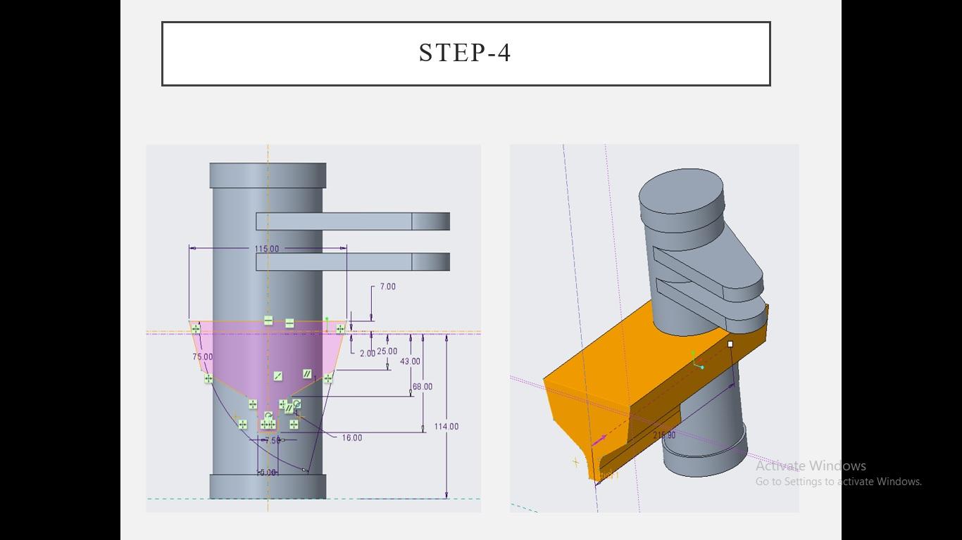

Step 4:

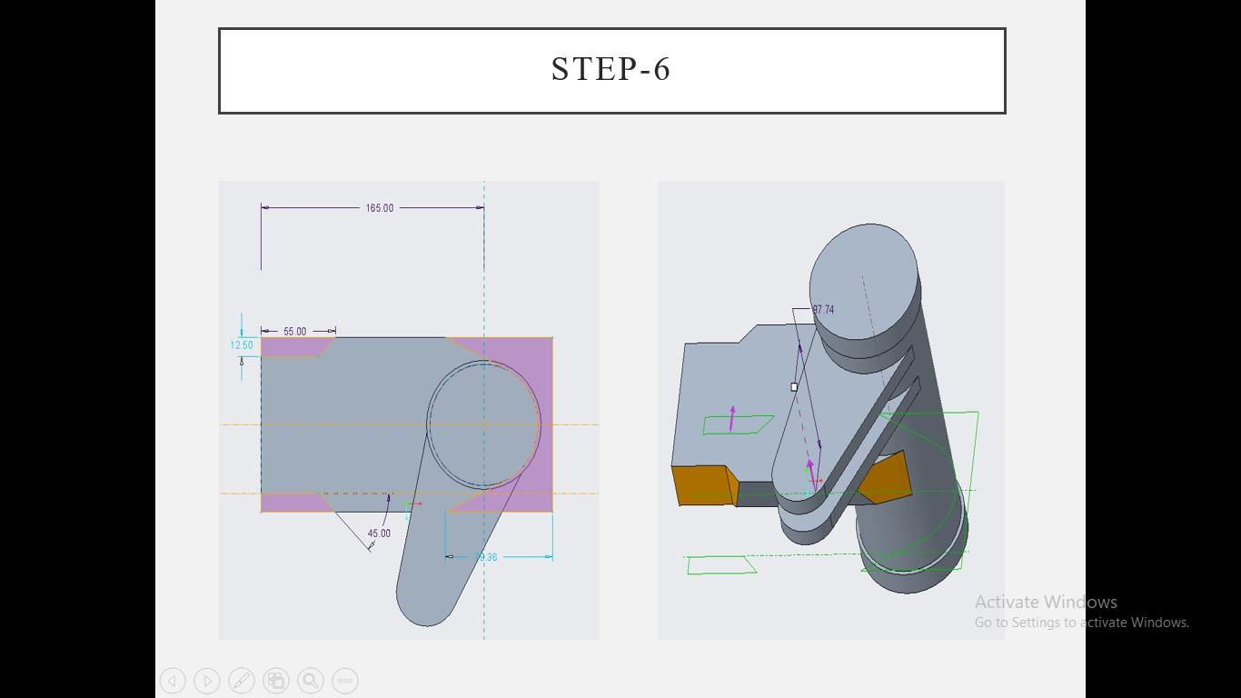

Step 6:

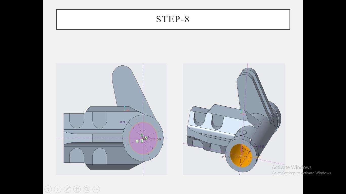

Step 8:

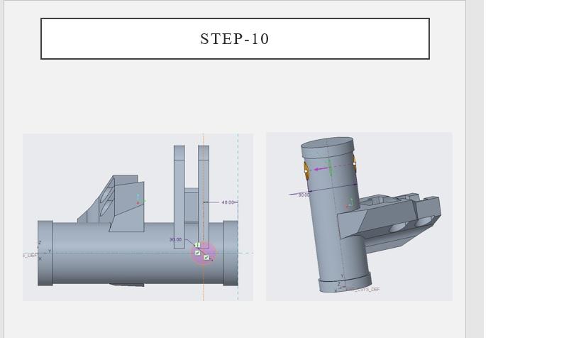

Step 10:

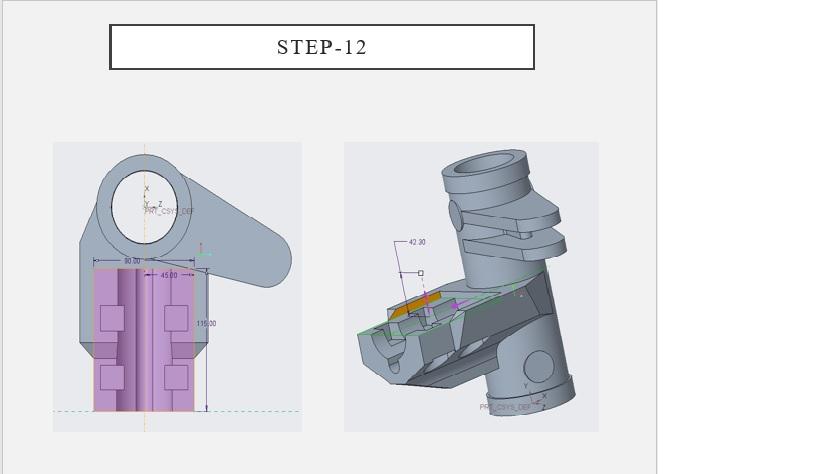

Step 12:
