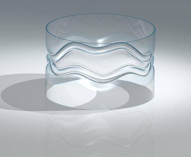

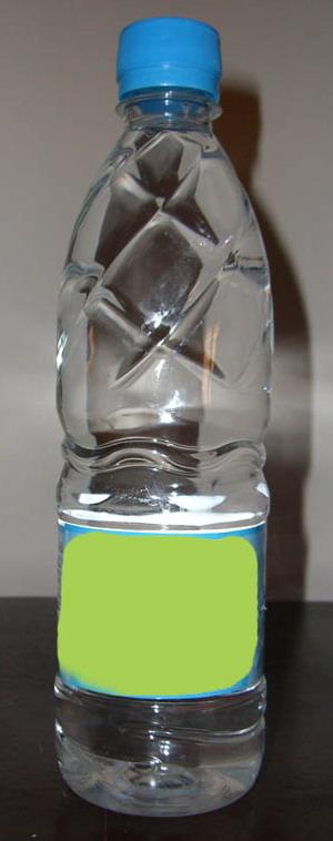

Group challenge to model this water bottle, which has a typical shape.

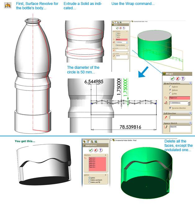

Step 2: Main Body of Bottle

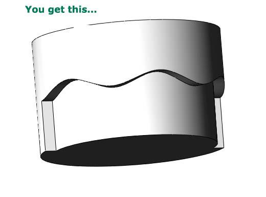

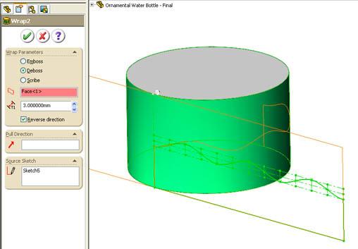

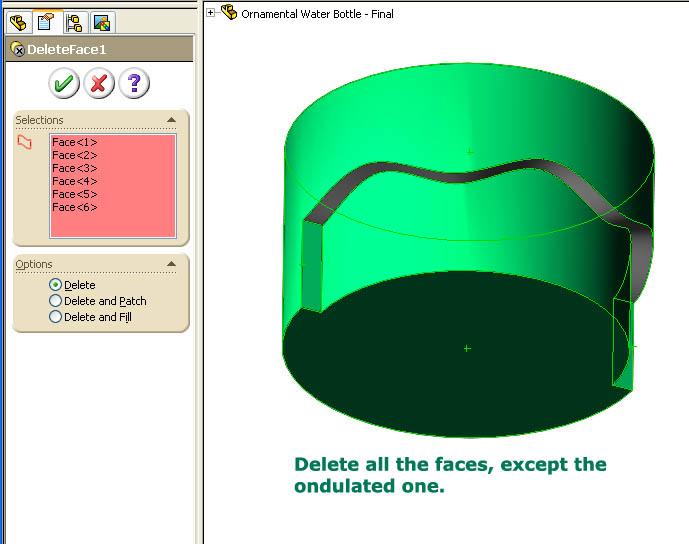

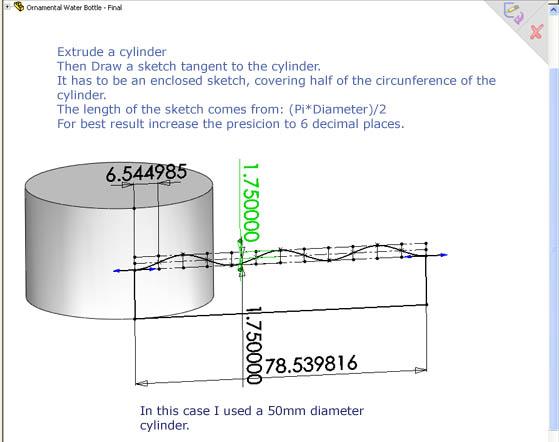

Here we can see the use of the Wrap command...
The main purpose oth this technique is to get an ondulated surface that will serve to trim the main bottle body, and to create the wave detail in the middle.
Yes, you can use other way, but this is a precise one.
Step 3: More on Wrap cmd and Ornament...
You can practice this technique aside, as we show here...
The goal, as we said before, is to get the wavy surface shown at the end

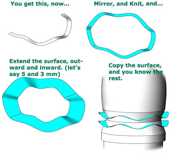

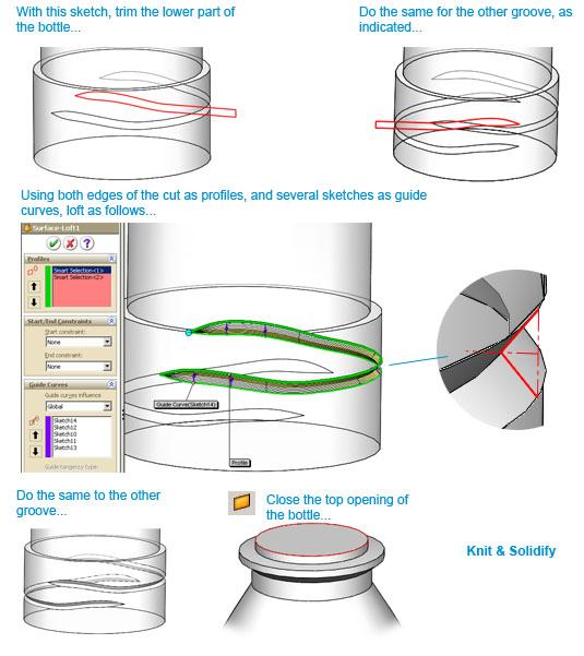

Step 4: Surfacing the waved zone

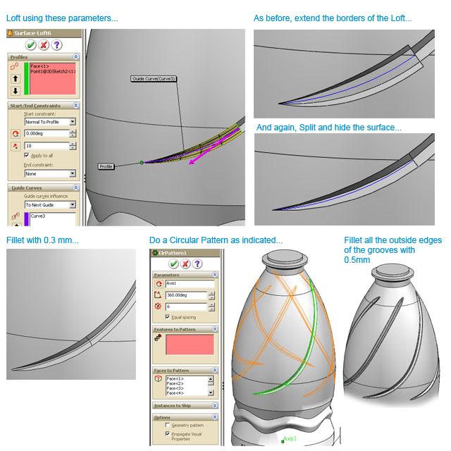

Step 5: Modeling the grooves on the Bottom
Step 6: Modeling the Grooves on the Upper Zone
Step 7: Cont...
Step 8: Final Stages...

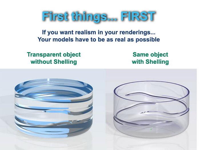

Step 9: Some Advises

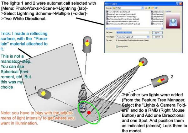

Also you can prepare your ambient for rendering. New versions of SolidWorks bring very powerful added tools for rendering, but even so, with older versions, excellent results can be achieved with some tricks.
