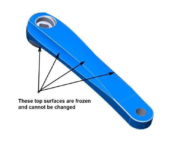

There are two cranks which need to be optimized: Right side crank with 5 bolt star shape Chain ring mounts and more simple left side crank.

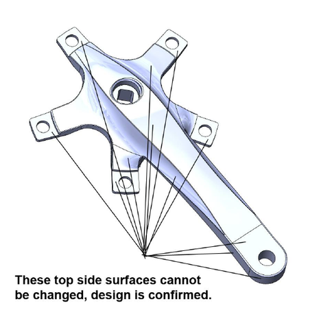

Current looks are well appreciated, so front sides of the cranks should stay like they are. Rear side and sides of the crank can be revised.
New forging tooling can be opened for both of these cranks.
Crank is under quite a stress while cyclist is pedaling hard. So the crank need to be safe enough to withstand the stresses of pedaling.

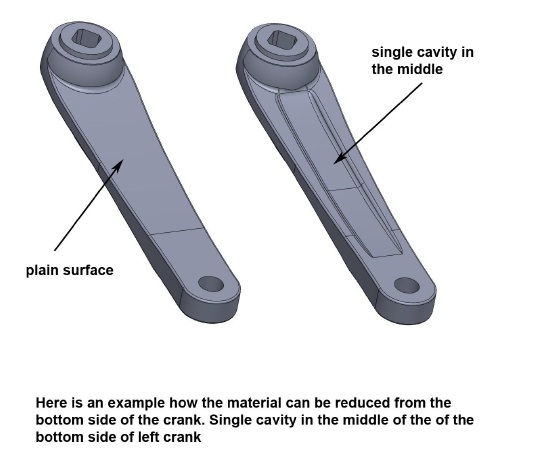

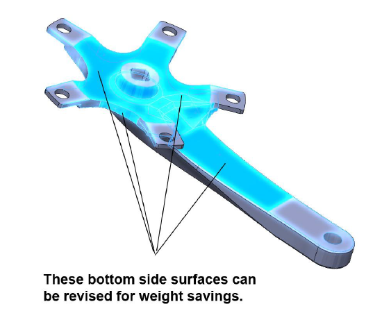

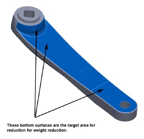

Rear side of the crank arms are aim for the modifications. See blue shaded surfaces in the images. Reference surfaces are added as 3D files for reference. These bottom surfaces are the target area for reduction for weight reduction.
See example how the material can be reduced from the bottom side of the crank: Single cavity in the middle of the of the bottom side of left crank.

  • Cranks are made with cold forging process, so the new shapes in the rear side need to be produce able in forging process
  • All surfaces need to have min draft of 3 degrees
  • Minimum radius in forged parts is R min 2mm
  • Max amount of separate cavities on rear side is 6 cavities
  • Min wall thickness is 4mm
  • Material is aluminum 6061.
  • Top side surfaces cannot be changed, top side design is frozen
  • Bottom and side surfaces can be revised for weight savings
  • Material can be reduced or added to the bottom side. Sides can be made thinner, as long as the top surfaces remain untouched

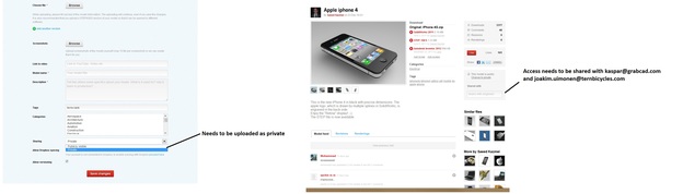

  • All the entries have to be private and shared access to joakim.uimonen@ternbicycles.com and kaspar@grabcad.com
  • CAD files will be sent by kaspar@grabcad.com together with the NDA.

  • Only models uploaded to GrabCAD library will participate in the competition
  • Only models uploaded through this challenge page here will participate in the competition

    Hi,
    No need to worry about surface drafts on the frozen surface sides. The sides will have rough forging parting lines, which are grinded out to look nice and smooth. Therefore there is no additional material beyond frozen surfaces.
    Frozen surfaces and selected manufacturing method causes boundaries comparing to completely free design challenge.
    Ranging and evaluating free design versions would require much more importance of aesthetic design evaluations, and then lightest and strongest might not win due poor visual properties.
    Here the task is from that sense easier as visually all entries look the same from main side.
    Here the aim is to get all suggestions target directly to the CEN strength requirements.
    So we could see the optimal situation for this design without additional safety factor.
    For possible tooling revision of these crank, we will add safety boundaries later on.

    Most failed on one or all of the following design boundaries:
    • Min wall thickness too thin. (min 4mm thickness)
    • Too many cavities (max 6 cavities)
    • Not enough drafting on inner weight reduction cavity surfaces (min 3 deg on all surfaces)
    • Missing or not large enough rounding (min 2mm rounding on all corners)
    As these modeling requirements are preset borderline boundaries, failure to comply with them disqualifies the design suggestion.
    This is due the required surface/ shape modifications would end up changing the weight and strength properties of the crank so it cannot be compared like it is any longer.
    Therefore low weight and/ or detailed FEM analyze on non comply design is useless.
    These design boundaries are even tougher than participating Tour de France with a bike that weights 6.7kg... regardless of how good it is, it´s still going to be disqualified from the race as UCI requires bike to weight min 6,8kg.
    But as these design boundaries are current material and manufacturing method limitations they cannot be bend, like hoped to do for arbitrary UCI regulations.
    It was a pity to exclude otherwise promising designs.
