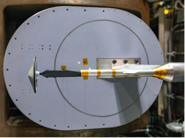

Hypervelocity Expansion Tunnel for Human-rated Entry Vehicles
NASA is reaching out to members of the GrabCAD community who may be familiar with or are interested in the testing of atmospheric entry vehicles. Currently, NASA has a ground-testing capability gap in the area of hypersonic vehicle testing in high-enthalpy hypersonic flow with chemically reacting gas for simulation of vehicle entry into Earth, Mars, and other planetary atmospheres. Defining the possible performance range of a hypervelocity expansion tunnel and developing a preliminary design will provide the necessary data required to advocate for funds to construct a new facility.
The goal is to develop a set of credible concepts for a hypervelocity expansion tunnel for ground testing of human-rated entry vehicles that provides a broad design trade-space for decisions on cost/size vs performance, leading to a down-selection for final design.
NASA has no facilities capable of producing the required test conditions and is forced to rely on external providers at a high cost and limited accessibility. Thus, design safety margins for entry vehicles have high uncertainties, which typically leads to higher mass designs to reduce risks.
NASA is looking for ideas that can be incorporated into the design of their next generation expansion tunnel facilities. We are challenging the GrabCAD community to design innovative concepts for an advanced hypersonic (Mach 5 to 20) expansion tunnel that can be used to study human-rated entry vehicles.
A successful outcome of this contest is a credible 3D model of an expansion tunnel.
The expansion tunnel must accommodate test models that have dimensions up to 24 inches (0.6 meter). The sample chamber design should have ample optical access to accommodate techniques like Schlieren, laser techniques, and emission/absorption spectroscopy.
Similar examples of such hypervelocity expansion tunnels can be found in the literature (https://doi.org/10.2514/6.2022-1602).
