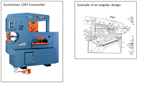

This prototype will be the second version of the OSE's Ironworker. It will similar to Scotchman 120T. As well as having the 120T punch. This prototype will be able to shear 1”x12” flat and 6”x6”x1/2” angle steel. There will be a “tool cavity,” a space below the punching arm to which many accessory tools can attach. This will enable the machine to not only have the features above, but also attachments like brakes, notchers, and rod shears.
The shearing element must be designed first, as it will attach directly to the cylinder, and the rest of the machine will be designed around it. See above for a basic idea of the structure of it.
Basic Structure of Prototype:
1. It will have an upper and lower arm, both attached to the cylinder. The lower arm will be attached to the cylinder directly or via a linkage. The upper arm will be attached to the lower arm via a linkage.
2. The upper arm will have the punch permanently attached, and will have a table below it onto which you can put various accessories, including an angle shear.
3. The lower arm will only have a shear blade attached.
4. Accessory tools can be made as necessary. Possible tools include: brakes, tubing shear, notcher, rod shear and more.
The shear design should be as simple as possible.
The winning design will be the simplest design that uses the least material.
An angularly moving blade is preferred, as they seem much simpler to build, but vertically moving designs are welcome as well.
If you have good ideas for the rest of the prototype, please post them. These designs will also be eligible for winning.

    "This prototype will be able to shear 1”x12” flat and 6”x6”x1/2” angle steel."
    I don't think there is anything on the supplier sheet that will cut 1" thick plate. I ran a 12' shear a few years back and 1" plate was not an option. Even with the larger "Buffalo Ironworker" machines, either punching, shearing rod/angle, etc., we never sheared anything in the 1/2" angle thickness that you are requesting. In regards to developing a Scotchman style machine to accomplish the task, the machine design as a whole and blade components will not successfully shear 1" plate.

    Can we have some more details on what materials are readily available to for you guys to fabricate it with?... Should my design be made from 1/2" thick steel sheets welded together, or can it be 1" thick? Bearings or bushings?... Mainly I don't want to model something that is nice and would work well, but there is no means for you guys to cheaply create.
    Allen has uploaded 11 CAD models & has left 20 comments.
  • Brianna Kufa
    Brianna Kufa almost 14 years ago
    Hello Allen,
    Anything that could be obtained at a local metals shop would be fine.
    It can be 1" thick or more of solid sheets. I suspect the arm for it will need to be 2+ inches, and probably made of 1018 or another stronger steel than A36.
    Please use bushings.
