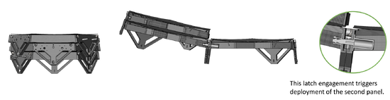

NASA is seeking innovative solutions for a synchronized antenna deployment system. The primary objective is to develop a mechanism that ensures sequential deployment of antenna panels, addressing a critical aspect of space-based communication technology.
In this challenge, participants are tasked with designing a mechanism that will release hexagonal panels in a predetermined sequence. Specifically, the mechanism should trigger the release of the next hexagon in a stack only after the previous one has successfully latched into place. This sequential deployment is crucial for maintaining the antenna's structural integrity and operational efficiency.
The proposed design must be compatible with one of the winning latch designs from the previous "Let's Connect" challenge. Additionally, it must integrate seamlessly with the provided backing structure model without compromising the parabolic surface of the antenna. Participants should focus on creating a solution that is both effective and adaptable to existing NASA technologies.

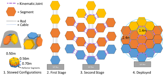

In space, there's a growing need to build large, precise structures like antennas, booms, and telescopes. These structures are too big to fit inside a rocket during launch, so we need a way to deploy them once they reach their orbit.

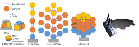

One idea for deployment is the Starburst architecture, which uses high strain rods to deploy and cables to pull the different parts together after launch. In our last prize challenge on this topic (Positive Connections), we asked participants to design a latching mechanism, that would latch the hexagons after the cable pulls them together. This new challenge will build on the previous results. The goal is to design a mechanism that will release the next hexagon in the series after latching.
Our key example is an Earth observing antenna. The antenna's segments are stacked neatly on top of each other, taking up a compact space (1). After launch, the segments are released from their locked positions, and a set of high strain rods deploy the system into an initial configuration (2). Each element is aligned correctly by two high strain rods, so they can be pulled together. Once the antenna opens up, the cables start retracting, gradually pulling in each segment until they form the final deployed shape (3). The segments are precisely located relative to each other using special joints, with an accuracy of around 20 microns, and held in place by the tension in the cables. (4) Upon fully deploying, the latching mechanism from the “Positive Connections” challenge locks the segments together. The overall surface alignment has a root mean squared (RMS) error of approximately 60 microns. Check out the image below for a visual representation of how the antenna transforms from a packed state to a fully deployed state.
LetitGo1

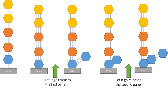

Initially, all the hexagons are stored in a stack. One of the challenges we have realized in our prototyping efforts over the last year, is that we can't just release all the hexagons at once. The result is too dynamic and they may collide with each other! Therefore, our goal is to have a system that will release the hexagons in the stack one at a time, after the previous hexagon is deployed and no longer moving. The goal of this challenge is to design a mechanism that will release the next hexagon after the latch engages, allowing steps 2 and 3 in the figure above to occur in smaller steps. See the second image below, with arrows where the “let it go” system will release the next panel after each deployment.
LetitGo2
Your goal is to create a mechanism the “let it go system” which will release the next hexagon after the latch engages. This will then allow our hexagon deployment to be sequenced, consisting of release, deploy, latch... which then triggers the next release, deploy, latch. This is where it connects to the previous GrabCad challenge. You can choose any of the 5 winning latch designs as a starting point for your design.

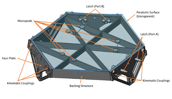

Below identify the key parts of a single hexagon which are useful for understanding the detailed requirements. Each hexagon consists of two key parts, backing structure which serves as the structural background, and a precision parabolic surface on top of the hexagon. The backing structure and precision surface are connected with a set of monopods. On the backing structure, there are face plates where it connects to other hexagons. On each face plate are three kinematic couplings, which connect each hexagon with each other with exactly 6 points of contact.

    Hello Jonathan, I have some doubts regarding the functioning of the system on which we have to work:
    1) In "Background" it is explained that after launching the segments are released from their locked positions and deployed thanks to a set of bars...
    Is it possible to know what this locking system is like and where and how the set of bars acts to reach the initial configuration (2)?
    2) It is also indicated that after configuration (2) the segments begin to retract until they reach the final deployed shape (3)...
    Is shape (3) not reached by the action of bars instead of cables?
    Is shape (4) not reached by the traction of the cables?
    3) If the hexagons cannot be launched all at once, and you want a system that releases them into the stack one at a time, once the previous hexagon is deployed and no longer moving...
    Wouldn't it be logical to give precise details of what the stack looks like, and how the hexagons are currently locked and unlocked, and how a hexagon moves out of the stack and into an extended position (stage 3)?
    Personally (and it's probably a limitation of mine) I don't understand the movement that a hexagon makes at the exact two moments in which they drew the green arrows that represent the action of the "let it go" system. Is it a lateral slide or a turn or something else? How is it achieved?
    My need to know these details is because, precisely, a design is requested that will act directly at those moments and on this movement that I don't understand, to transform it into sequential instead of simultaneous.
    Thank you very much for any clarification you can provide. Best regards!

    Hi Flaviano. You are correct that these are not quite hexagons. In the papers we write, we call them Semi-Hexagons. This is because it is impossible to map a hexagonal surface to a parabolic surface, therefore the edges and sides are each slightly altered. Each interface will be slightly unique, and there will be a small gap between each of the panels when deployed. I hope this, and your second post clarifies things on your first question. For the deployment mechanism, you only have to show a mechanism which releases one of the hexagon, not design a slightly different geometry for each of the 19 use cases. We will take the winning designs, and adjust them as needed to work with each Hexagon.

    Marcelo, thanks for the question. The first image, with the labels 1, 2, 3, and 4, were from an earlier design concept where we released everything at once. We are realizing this concept will not work, so instead we need to release the hexagons one at a time. I apologize for any confusion this may have caused, and that things were perhaps not clear in the challenge statement in terms of this point. I will attempt to create a video and upload it to YouTube, showing a small prototype we have on hand that will explain the prize challenge. It may take me a week or two to get the video approved for release by NASA, but this should clarify the challenge.

    Thanks Jonathan, I am very clear about the limitations of working on protected themes and developments. However, what you reveal will be the compass for all designers and the precision with which it points north will determine the places they will end up.

    "On each face plate are three kinematic couplings, which connect each hexagon with each other with exactly 6 points of contact." Following the rules I found empty spaces without the possibility of connection.
    diagram: https://cdn.discordapp.com/attachments/1292178277691293808/1292377535698436096/HEXAGONAL_TESSELATION.png?ex=670383df&is=6702325f&hm=16e49b5dffe5f166c31a93889475d62ad3323bda183fe14e97e7e87ab5f020f5&
    sorry if I didn't understand it correctly

    Can you please reupload the CAD files. As tried assembling 5 Panel assemblies. In certain place 2 panels clash. Reason being Reflector panel is slightly tilted compared to the structure underneath.
    Kinematic Coupling:-
    Using the current design of mating 6 faces with 6 faces is impossible due to machining constraint and end up costing lot more.
    Solution:- To replace the Male 'V' with Cylindrical or Spherical shape. As it is much more easier, cheaper to achieve tolerances on these shapes and recommended when in comes to kinematic design. Secondly these shapes self align, so we end up having line/point contact.
    Examples:- Fibre Optic in V-groove, Optical Kinematic Mount or Pipe in V-Block for Drilling.

    Hi All, I have just uploaded a .mp4 video to my profile under the "Let It Go NASA Challenge Reference Model". This should help make things clearer. Please note that you are designing a mechanism just to release one panel, as the panels are released on at a time. So you don't need to worry about the entire configuration. Just the next panel that gets deployed.
    Jonathan Sauder has uploaded 1 CAD models & has left 32 comments.

    I think the video should cover/clarify many of the questions above. Let me know if there are still open questions that were not resolved in the video.

    I noticed the following factor: when the sectors are stacked they must compress the two pins of the Egyptian key device in the rear position so as not to interfere with the next overlapping sector. In fact, on the new models you uploaded I noticed that the two pins push on the triangular part of the upper sector. During the extraction of the sector it is therefore necessary to overcome the friction force of the tip of the two pins. Let's hypothesize the forces in play.
    The spring of the device in the hooked position is about 62.5 mm long and at this height it must exert 25N to widen the two hooking wedges. To do this it must be pre-compressed from its maximum free length. When the pin is completely retracted to allow the overlapping the minimum length becomes 20 mm. Since the load diagram of the compression springs is mostly linear it means that the thrust exerted increases to about 80N. So the pair of pins pushes the upper sector sideways in one direction only with a load of about 160N, in my opinion making it very difficult to remove the sectors, because the resistance exerted by the pins will tend to rotate the sector, as happens when you try to open a box with very long lid edges. If the traction is not perfectly balanced it does not slide out but remains stuck.
    I also noticed a dimensional error on the pin, it can move by 1.1 mm, because its flange does not rest on the internal face of the sector making the assembly unstable, clearly this is a preliminary model that needs to be improved.

    Hi Flaviano, good observations. I used the winning latch design mostly unedited from the prior challenge as an example. However, individuals in this challenge can choose from any of the 5 winning latch designs. We are modifying the latch design at JPL, and combining ideas from the 5 winning concept from the prior challenge to make it work in our application. It is not expected that submissions will have every design detail flushed out. The same is true for this challenge. We choose the winners based on the judging criteria, and usually we can't use the design completely as is. Note that the latch positions do not have to be fixed in their current location. They can move around provided they don't interfere with the other hardware.

    Jonathan, I understood the need to contain the masses of the system and we can limit ourselves to designing the deployment of three panels as exemplified by the Cad files that you made available, but I would like to understand the general point of view in order to stimulate reflection:
    1- The sectors are sent into space stacked on top of each other.
    2- The system must separate four packages already connected by ropes; (refer to the colored sketch) which therefore contain:
    5 Blue
    5 Red
    5 Red
    3 Yellow
    + 1 Yellow
    3- For each colored package, two sectors must be positioned on the left and two on the right.
    4- When all the sectors are deployed, the various colored groups must be pulled against each other to assume the final position of the dish.
    Watching videos of antenna deployment devices I noticed that many times parallelogram extenders are used, but in our case it seems difficult to use them.
    Referring to point 3 (movements of the 5 sectors), the central sector will remain still, the other two sectors must not simply be moved away, but must undergo a rotation to allow the ropes to arrange themselves parallel, and this is the difficult thing. Furthermore, the left / right systems must be specular and I suppose that the two on the right are stacked under the central sector. So doing the math the deployment devices must be 5 + 8 = 13 with the relative masses. The challenge is therefore to contain the weight, to be compared with a single robotic arm reduced to the bare minimum that could easily solve the rotation problem. Clearly your experience is superior in evaluating all these aspects, and in conclusion the task remains to design the positioning as represented in the file: "GrabCAD_assem4_third_latch_engages". and then the concepts found can be extended by analogy to the entire system.
    I'm curious: what color would the sectors of this file have? and are they the ones on the right or left of the central sector?, I bet they are on the left :)

    Hello Jonathan,
    In your previous file, there was uniform clearance between two stacking panels, but now some sides (legs with thickness 13.49 mm) do not have any clearance.
    Can you clarify if there is an uniform clearance between the panels or if it varies?
    Also provide the clearance size as well.

    @Flaviano, the CAD model is for the 3 blue sectors, which include the center one and the two to the left.
    @Nazarii, the entire system does not need to be developed. Just as you stated the "is it just a system for cyclic release of the next segment with an abstraction of the overall system". This task is not extremely complex, and there are several solutions that seem obvious in my mind, but the beautiful things about prize challenges is getting unique creativity applied to the solution. It is much better to have a number of diverse minds thinking about a problem from around the world, to see what implementations come up.

    @ Neon, the height of the stack should be uniform, but the edges of the hexagons are not uniform. Design to the hexagons provided, and we can take the solution and modify it to the other geometries.

    @Mellville, you can assume the assembly speed will occur no faster than 5 cm/second. Note it is permissible for the mechanism you design to move much faster, as long as there are no major impact forces when it stops.
    @Rishit, the key difference with this antenna is that each hexagon is a rigid, non-flexible segment. The Umbrella style antennas with film/mesh can only work up to about 50 GHz, maybe 100 GHz if you get the right mesh technology developed. This antenna will work up to 250 GHz.
    @Nazarii, Sorry for the confusion, there are 3 long rod like elements. There are 2 high strain rods (these are on the right and left), and one cable (in the center). The high strain rods unfold the stack. Then the cable is actuated to pull the system together, guided by the high strain rods. I hope this makes more sense. There is a paper with more details on this here, but unfortunately it is behind a paywall by AIAA (unless you have access through your university, etc.). https://arc.aiaa.org/doi/abs/10.2514/6.2024-0184
    @Sawyer, this is standard rules for NASA CAD prize challenges. This is something determined by the NASA Prize challenge organization. Not sure if there is a question there.

    @Nazarii, I found a copy of a report I can upload without violating copyright agreements. It is entitled "NIAC_Starburst_Final_Report_2024.03_27_accept_all.pdf" I have included it in the files on my profile, with the CAD files for this challenge and the video. I should note this is slightly outdated, but contains much more details on how the system works. Sections 4 and 6 should be helpful, especially 4.1. I hope this is helpful.
    @Neon, to clarify this challenge focuses on the first step you mention (lock the panel together), and then the second step, unlock when the prior latch secures into place (note it is also permissible to use the locations of the two surfaces when the latch engages to trigger your unlock action, instead of be directly actuated by the latch). Steps three and four will be done by the deployable system we have already designed, so you don't have to include those on your design. You can assume the system will take care of the push off and mating of the panels together.

    @Jonathan Sauder From your drawings and instructions and the deployment diagram, when a certain strip of segments uses opposite connecting faces, it is clear that the side triangles (those sides where the kinematic and blocking connections are) overlap each other very often. That is, in addition to the fact that two triangular sides are connected, there is also a third between them, which belongs to the next segment (and it will slide out from between them, which are already connected).
    And this means that in the current position of the blocking elements it is a collision with that triangle, so the blocking elements should be on the side where the triangles do not create a collision.
    That seems exactly right. I just see that some works ignore it.
    So, confirm that it is all correct and that there will be a third between the two connected triangles.

    I would like to know whether the diameter between the vertices of the hexagon = 0.56 meters or whether this distance is the length of its sides

    @Flaviano, the Egyptian key design may require additional tooling or a fixture to unlatch it, or new features in the design. It is expected that modifications will need to occur on the designs to enable it to be used.
    @Nazarii, I’m trying to understand your question without pictures, but I think you are talking about the unused “face plates” with the kinematic mounts. While it should be clear the face plates in contact with each other in the model need to allow assembly, we never specified in the rules whether the other triangle faces can or can’t be used. Therefore, it should be assumed these faces can be used, even if it would prevent future deployments on those faces. Note, not all the faces with triangles will connect to other panels. Only the root or “base” panel will, with another set of two panels extending to the right. If you can consider this in the design, that is helpful for us, but given this was not explicitly written in the rules, it will not be part of the judging criteria. If i misunderstood your question, please let me know, or feel free to upload a diagram on your profile to explain and I can take a look.
    @Ali Khteeb, I will get back to you on this.

    Nazarii Vareshchuk about 1 year ago
    @Jonathan Sauder
    This is an additional explanation to my question.
    SinglePart
    There is a file "1.jpg" (you can save it for better detail).
    Thank you.

    @Nazarii, thank you for the clarifying figure! Good question, and I'm glad to see you are thinking about the future implications of having multiple panels in the row. For the purpose of this challenge, going beyond the three panels provided does not need to be solved, but doing so would provide extra points to judging criteria 6 and 9. Note that for the four sets of four substacks (the only set of 4 to 5 panels in a row), with the design as shown, we can stack them in such a way where this is not an issue (as the side panels are at an angle, so don't have a triangle covering the latching interfaces for four in a row, and then by the time we get to the next sub-stack in height, the triangle is already far enough away it does not cover the latches).
