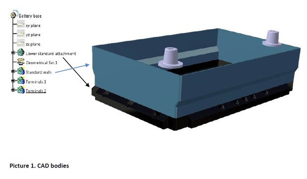

  • Size and shape restrictions:
    - The shape of the lower attachment must remain unmodified but it does not have to be a separate piece, just integrate it to your designed part. (CADbody „Lower standard attachment“ in attached file „LitePlus battery base“).
    - The shape up from lower attachment doesn't have to follow the given walls but should remain inside of the walls. (CADbody „Standard walls“ in attached file „LitePlus battery base“). See picture 1.

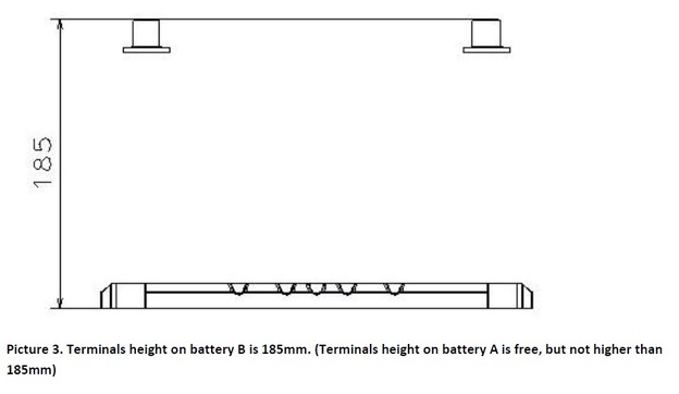

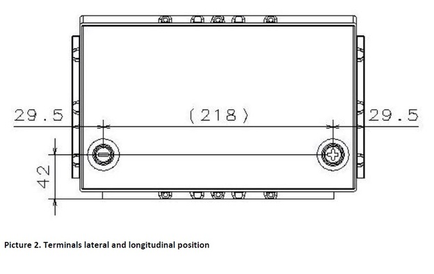

  • Terminal location:
    - The 2 terminals should be at the same height.
    - Terminals lateral and longitudinal location measurement should remain the same as on attached file „LitePlus battery base“. See picture 2.
    - Casing A terminals height is free, but not higher than 185mm.
    - Casing B terminals height is 185mm measured from the top of terminal to the bottom of battery. See picture 3.
    - To be able to attach the car’s wire terminals, there should be at least 30mm free room around the battery terminal, measured from terminal centre.

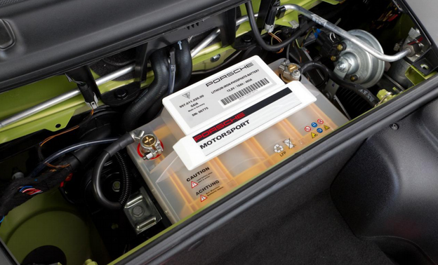

Lite Plus is developing lightweight Lithium-Ion 12v starter battery for spirited driving experience.
Our batteries employ Lithium Iron Phosphate elements, integrated battery management circuits (BMS) and status display, providing longevity and performance. Lite Plus Batteries are a replacement for Lead Acid technology.

  • Girish.K.S
    Girish.K.S over 12 years ago
    Hi,
    Please reply to the queries given below.
    What are Battery elements? pls explain - "Casing A consists 1 battery element.
    - Casing B consists 2 battery elements." ...
    Any spec on Inner volume?..Its mentioned that the Outer profile of design proposals should not exceed the standard models given as attachments like wise is there any constraints on the Inner profile of design proposals.
    Terminal Location and Heights are given ; is there any contraint on the casing upper cover height
    Please provide the Information for existing designs or production parts for following
    - Solution to attach battery terminals to plastic case.
    - Solution to attach different case parts.
    - Solution to fix battery elements inside of the case.
    Thanks
    Girish.K.S has uploaded 11 CAD models & has left 10 comments.
  • Risto Kõiv
    Risto Kõiv over 12 years ago
    Thank you all for showing so much interest on this challenge and asking the questions. Below are some answers.
    To Marcel Bakker
    Yes, the case needs to be water tight
    The elements connect to the terminal through cable or sheetmetal stripes depending on the design
    No extra clearance required between given battery element and case
    To Timo
    It is more design and styling contest, less engineering challenge, but after the contest we have to be able to apply the design to actual product and if the elements don't fit inside or there impossible to produce it, we cannot use it. Therefore we have specified some engineering points under paragraph 4 „Things to consider“. These are the first considerations our engineers have when they look at some design. You don't have to finalize all the engineering considerations, but if we cannot find any solution for those considerations, then we connot use this design.
    There should be two casings - one for battery A and the other one for battery B, but both of them have to have the same design style.
    To Girish.K.S
    There are no other inner volume restrictions other than Battery A should consist one element and battery B should consist 2 elements. The elements are in the stp file.
    Casing upper cover height is defined in paragraph 2.3 and 2.4
    There is not one and only right solution for paragraph 4 considerations and we don’t expect full solution from you. Just some solution needs to be applicable.
    Good luck!
    Risto
    LitePlusvv

  • Paul
    Paul over 12 years ago
    I noticed that the terminal locations in the provided case model disagree with the locations given in picture 2 (the model seems to have been measured from the case side wall and picture 2 is measured from the attachment base). Which is the correct location?
    Thanks,
    -Paul
    Paul has uploaded 3 CAD models & has left 6 comments.

  • Risto Kõiv
    Paul,
    I double checked. I cannot see any mismatch. Can you be more specific?
    Risto
    Risto Kõiv has uploaded 0 CAD models & has left 4 comments.
  • Paul
    Risto,
    Thanks for your help. I was still using the first model provided. After getting the latest model the numbers match up. Sorry for the trouble.
    thanks,
    -Paul
