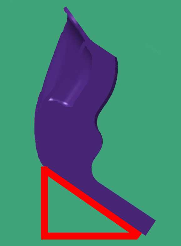

So, I need to print this Model and I don´t know where to place my support. I use Cura as my slicer, but Cura places the support material exatcly like shown in the picture bellow. (red lines)
I need those surfaces in good quality, so the support will ruin it.
Please help me with this!
Thanks
Sebastian
Is the appearance on the other side of the part critical? you could flip it and have the rough support surface on the inside of the part.
Or rotate it 45° and let it self carry from support at the bottom. I am not familiar with Cura, does it let you manually place support? I know in simplify 3d you have lots of control.
The original model (which I am not allowed to share due to data privacy) looks more complex than that, in fact it is a shaft, so the only flat surface is the one shown in my picture. That´s why the model has to be printed in that direction.
