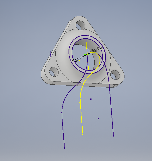

I am trying to model this, but im struggeling to make the path for the sweep to follow. How can i combine the 2 radiuses in 1 sketch, or get the sweep to follow a combination of the two!?
you can end a two-dimensional sketch at a projected point, and then select the path-segments you need.
But I would recommend you make two, two-dimensional sketches and after those make one three-dimensional sketch in which you use the two previous sketches. (there's a command to make a 3d-projected line from two curves.)
I agree with Phil Green. I have not uploaded the file here because I am still up to date, but I have replaced it with pictures.
Thank you @정성원 That helped a lot.

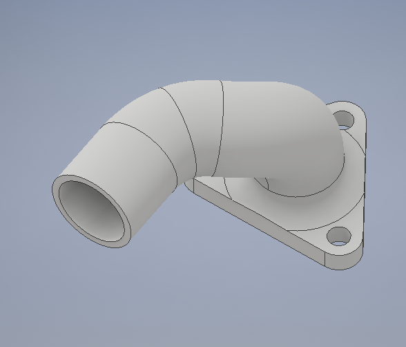

And there is one thing I would like to add, so I'll add it.
In the original drawing, a line should be added to the round (fillet) part.
If you check the detail option like the image, it will come out with the original drawing. :)
I hope this helps.
