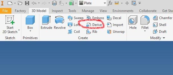

Duplicate a solid Mauro 4 Dec, 2024 07:51 PM Is it possible to insert a solid body of an ipt file into another ipt file where another solid body is already present? Thank you 2 Answers Bob Wiley Answered on 4 Dec, 2024 09:15 PM Yes. Use the "Derive" command on the "3d Model" "Create" panel. derive.JPG TB-KS-01 KEYSTONE TOOLBODY.ipt KEYSTONE_TB_EXAMPLE 1.ipt Mauro Answered on 4 Dec, 2024 09:21 PM tank you so much!
