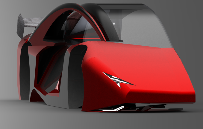

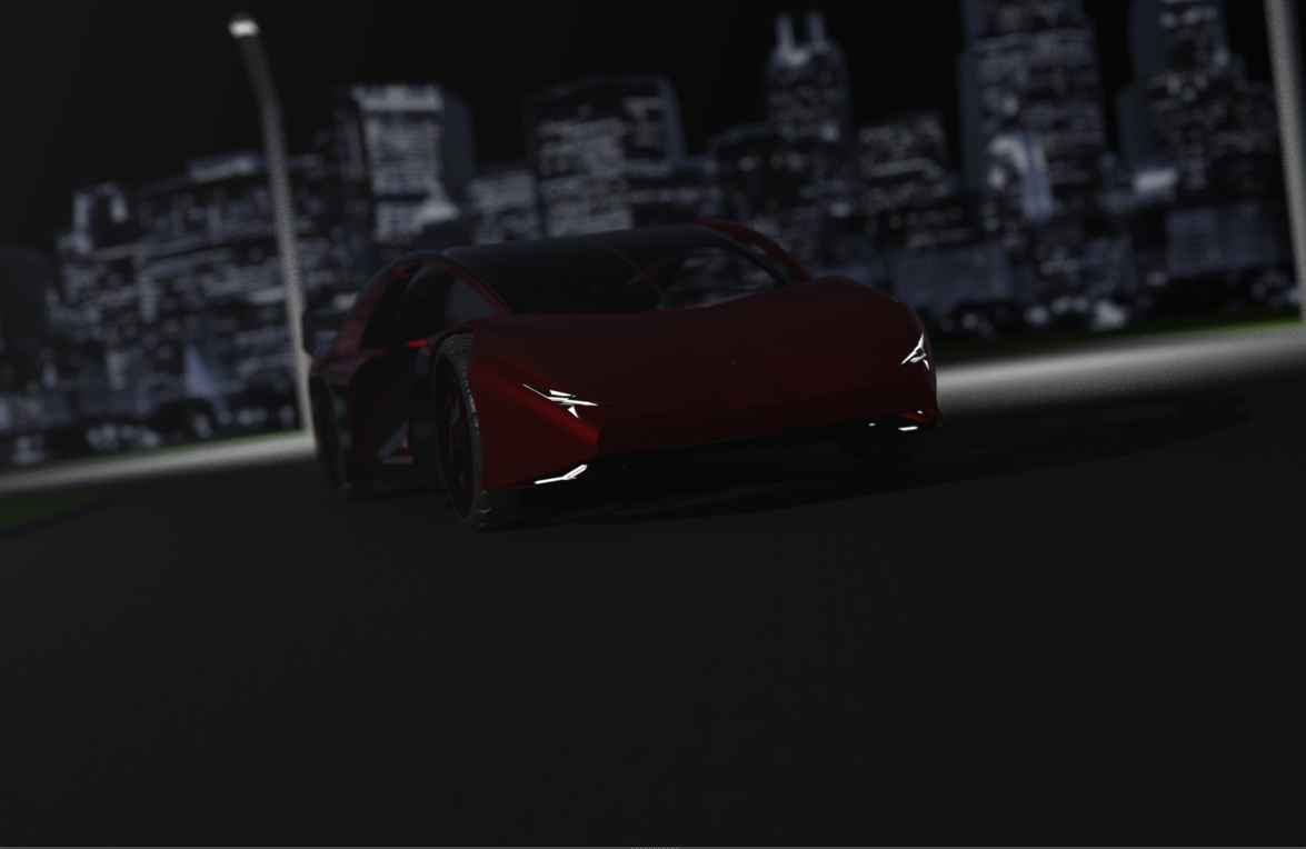

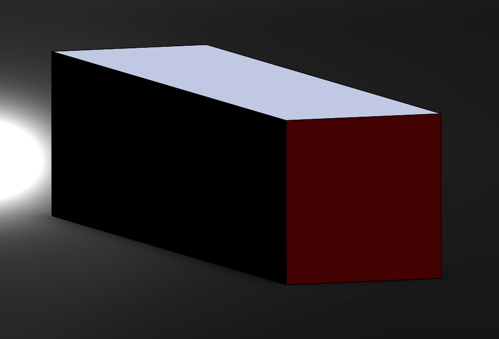

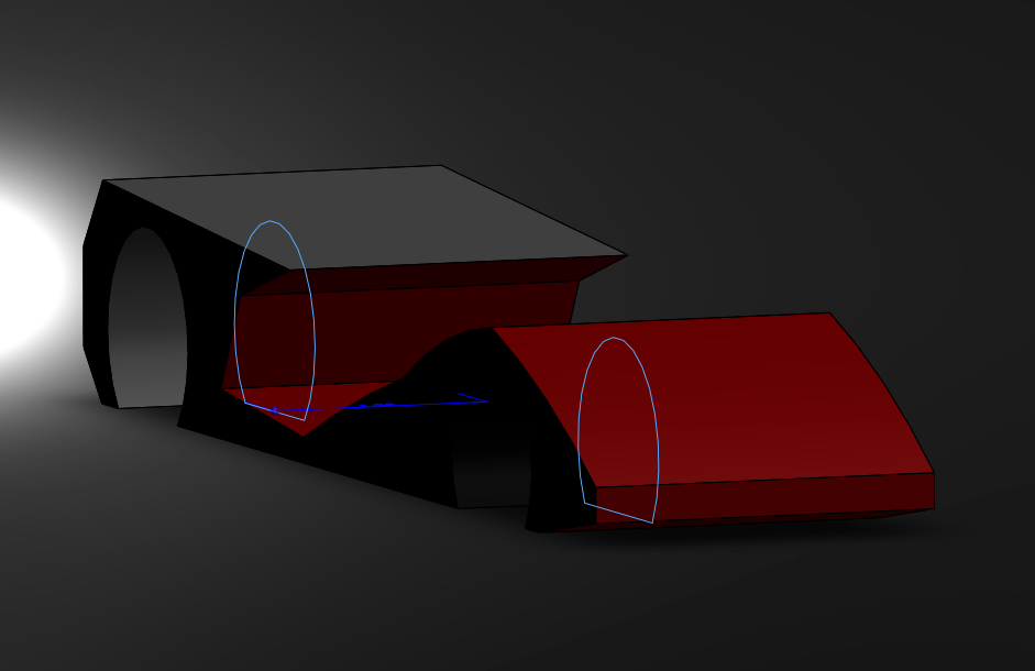

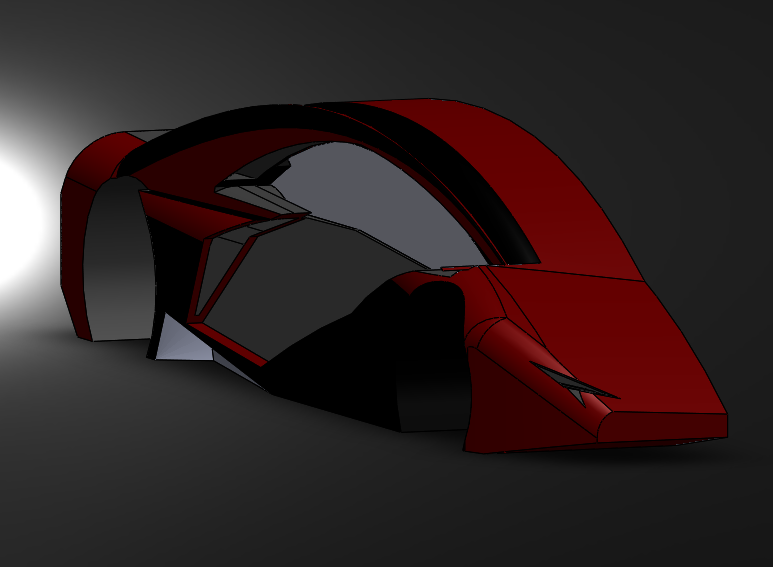

I build all of my cars as solid models starting with a block and slowly cutting away till I get a good shape. The more advanced method is using surfaces to build them. I am not so experienced with using surfaces however.
There are only 2 surfacing tools i use, the majority of the time. Those are:
Surface fill
Lofted Surface
I also mix in solid modeling. This is the 2nd car Ive modeled. The tools aren't too hard to use, but it takes a long time while modeling to get something nice.
