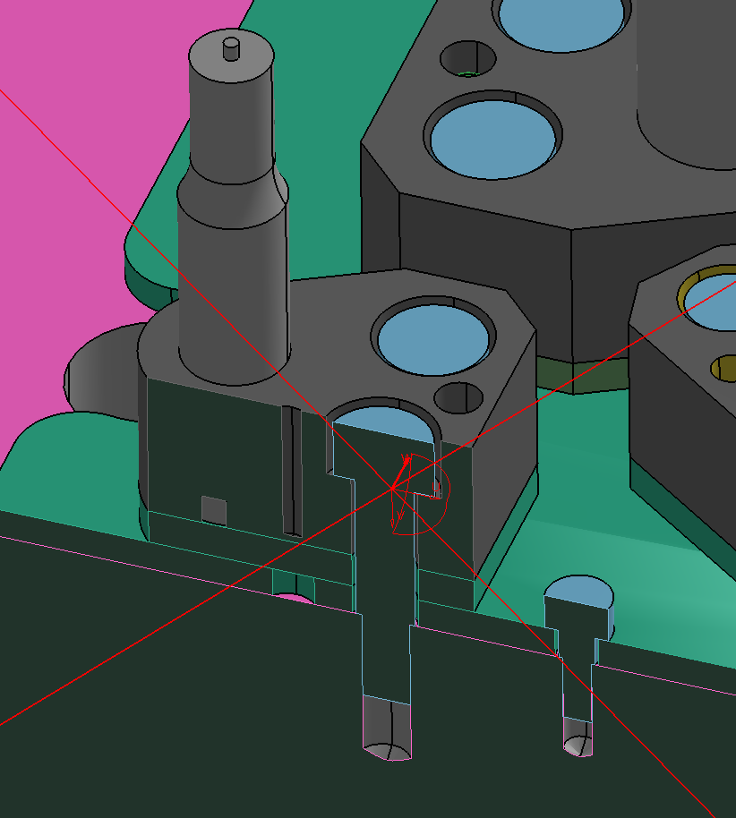

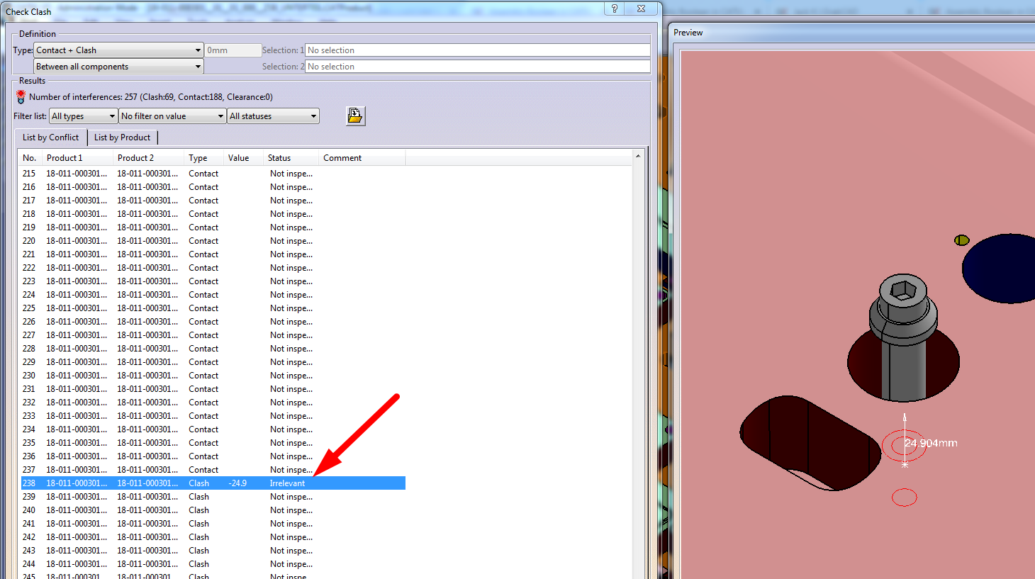

Well explained, but what I don't like is that example that you show through tutorial is not practical. We made detailed thread in several cases only:
In common practice made of detailed thread geometry is unnecessary. For example, in large progressive or transfer die tool design you need to operate with large base plates with 100+ holes with thread on each. Imagine this model with detailed threads geometry: your frame rate in CATIA will drop on 0fps.
What we do:
