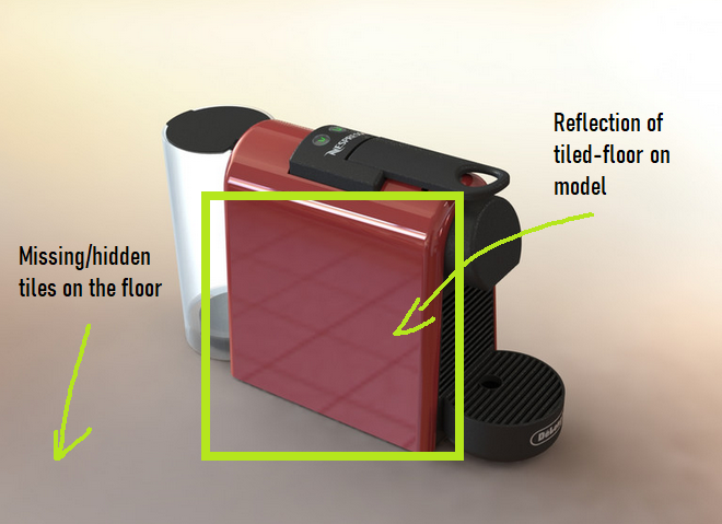

(----See attached picture----) I was going through your profile and saw this "tiled-floor" reflection on the Coffee maker model. And strangely the floor is not rendered that way. So, here I am guessing some setup fault probably - like you are not using the Environment in render settings.
