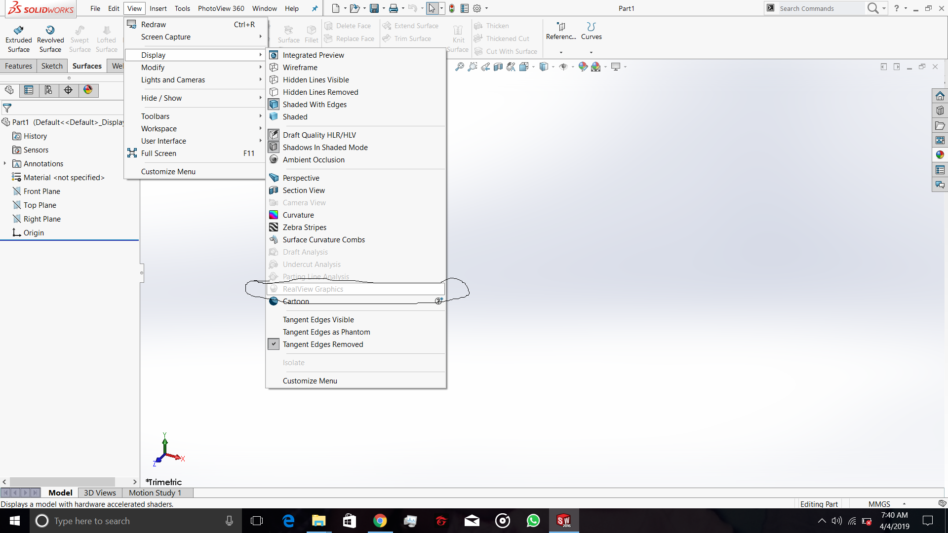

can anyone tell me about How to enable REAL VIEW GRAPHICS in Solid works ?
Thank you for your reply Rich Reavis but for me real view Graphics settings wont highlighted to click it
help me
Gokul, you probably have graphic card type with no CAD support stuff (like Quadro) or you shall play with settings of graphic card.
i have AMD Graphics Chipset
Radeon(TM) 520 (2GB Graphics)
I Already tried it bro
but IT Wont work
Bad news....
You can use only standard functions of SW graphic
Realview and other are extra stuff for CAD graphic cards only......
As I googled here :
https://forum.solidworks.com/thread/97702
"Radeon Card is gaming card, NOT certified to run SOLIDWORKS:
Here are the lists of graphic cards that are certified to run SOLIWORKS Graphics Card Drivers | SOLIDWORKS"
Regards
ya regedit worked but my graphics card is Radeon(TM) 520 so i changed the values in r300 it worked
Thanks a lot
finally i enabled the real view graphics
Thanks a lot for your suggestions
Thank you
Thanks bro but today morning I enabled real view graphics using regedit
And it works
Thanks for your reply
Really works as expected and looks better?
The registry hacks works very well for Radeon Cards. IMO it is the biggest SCAM in the CAD industry that you need so called professional cards. I use Radeon 570 and 580 and they display Realview perfectly...! So does my Quadro 600, but it is a drag for everything else but Solidworks.
