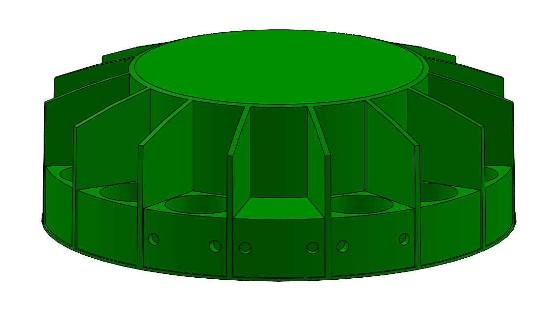

I have having a problem with the Circular Pattern Feature of an Extruded Cut on my carousel. I want to make two extruded cuts on each compartment of the carousel as shown in Circular Pattern Cut image.
It shows the preview as going all the way around the carousel, however, when I execute the circular pattern it only shows up on 3 out of the 15 compartments of the carousel, as shown in Circular Pattern Output image.
The top view shows that none of the cuts collide with each other or anything.
Does anyone know what I am doing wrong?
Thanks
@FredSWUG I'm not sure how this happened but it looks I have multiple bodies which is causing the circular pattern to only cut into the highlighted body in the image. No idea why this is happening.
