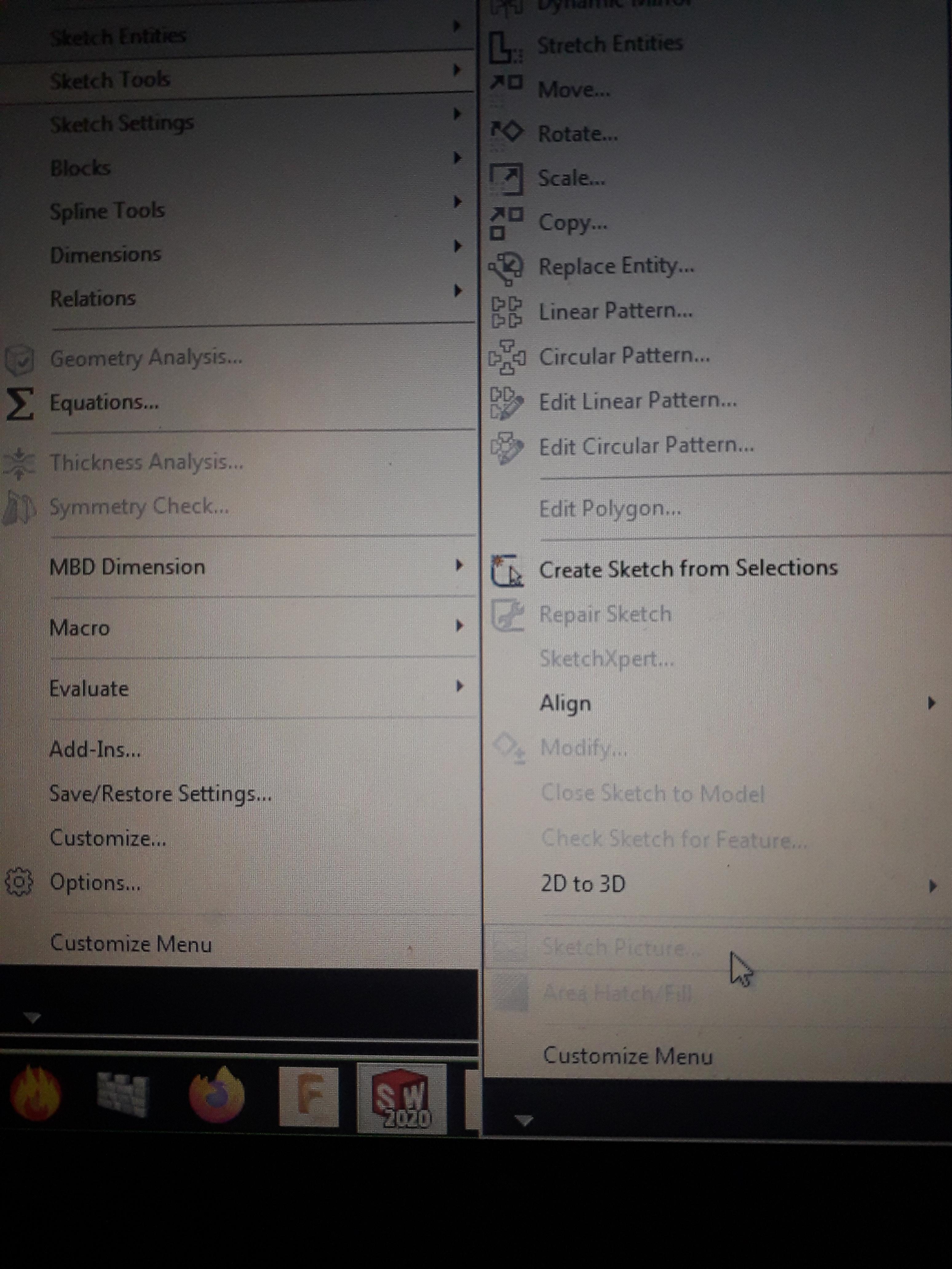

I'm unable to use Sketch Picture in Solidworks. Its grayed out
I tried to add a blueprint to a sketch but I'm unable to because sketch picture is grayed out. When I click on it nothing happens.
2 Answers
Select Sketch and sketch plane after that you insert picture
Hi
You have to be in Sketch mode for the "Sketch Picture" tool to function otherwise it will not work. After that you can add in your picture and edit it from there.
