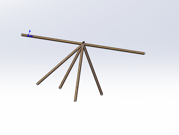

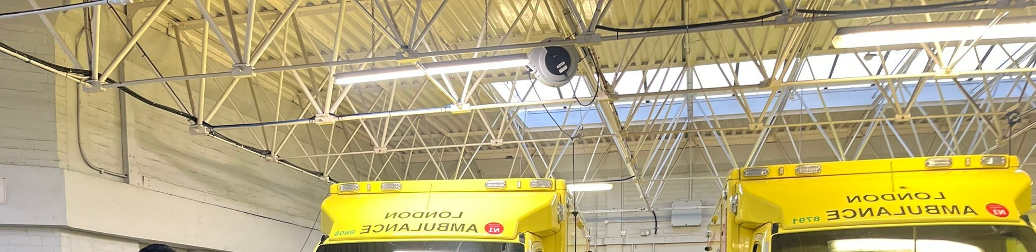

What are the sticks in the following picture called? Muhammad Furqan 1 Nov, 2023 10:15 AM Is there a technical term for these sticks? I think these are trusses. But not sure. I need to make a 3D model of the roof. Inner view.png Accepted answer Muhammad Furqan Answered on 2 Nov, 2023 10:15 AM Roof space truss 1 Other answer clown king Answered on 2 Nov, 2023 02:44 AM I use weldment of tube to make it. Snipaste_2023-11-02_10-44-05.png
