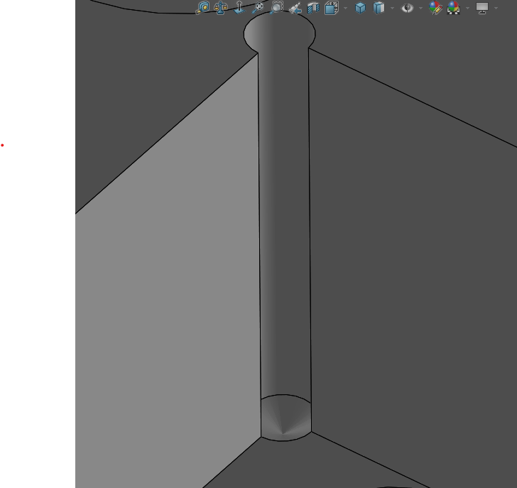

Nice work on the model – it looks very clean and well-detailed.
One small note from a manufacturing perspective: the corner holes in the pocket currently have flat ends matching the pocket’s bottom surface. In practice, drilled holes would have the typical 118° tip angle, so you might want to keep the drill cone in the geometry to reflect how it would actually be machined.
Just a tiny detail, but I thought it might be useful to point out.
(Attached an example with the drill cone for reference)
