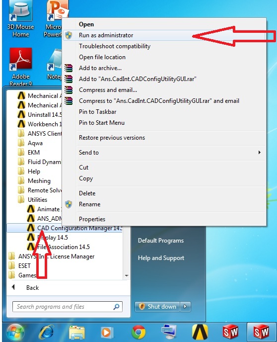

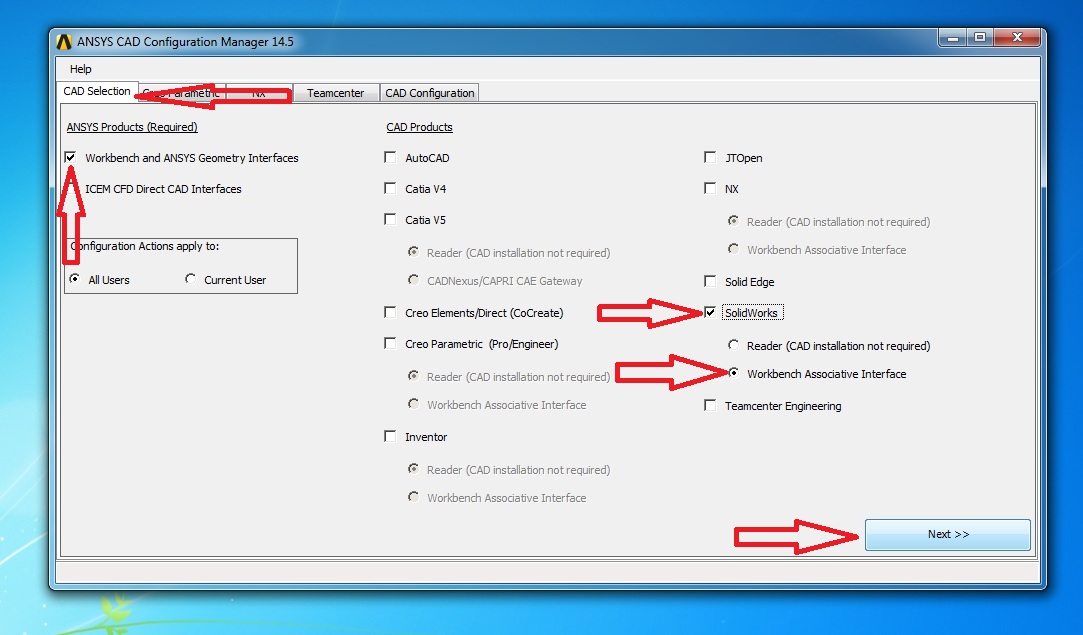

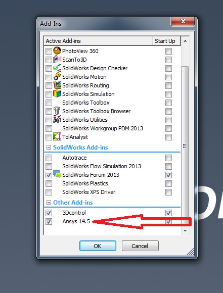

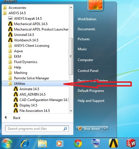

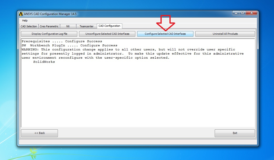

    To enable Ansys in SolidWorks, please see the attach pictures :
