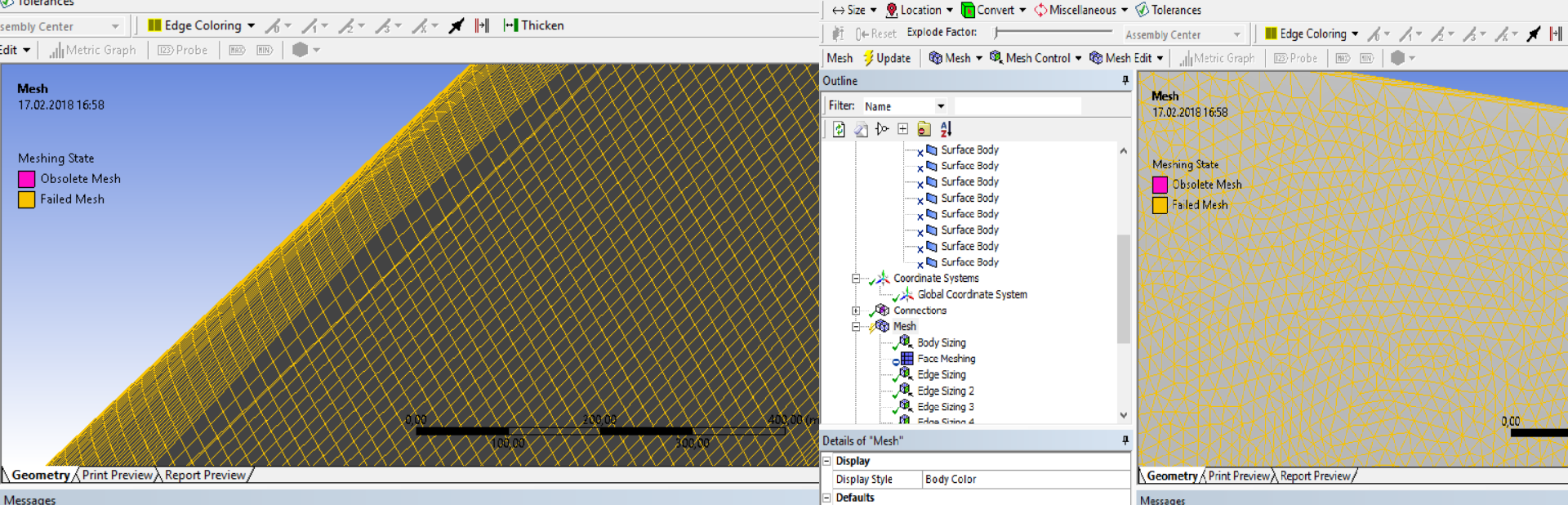

Ansys wing meshing problem
hello guys l am trying mesh my wing for fea analysis but my mesh giving bad result for up skin but bottom skin givin fine how can l fix this
2 Answer
Try to remove face meshing and also make your model as water tight solid
There is an error with Face meshing. Try remove it and use All Quad or Quad dominant method using mesh control.
Hope this works.
