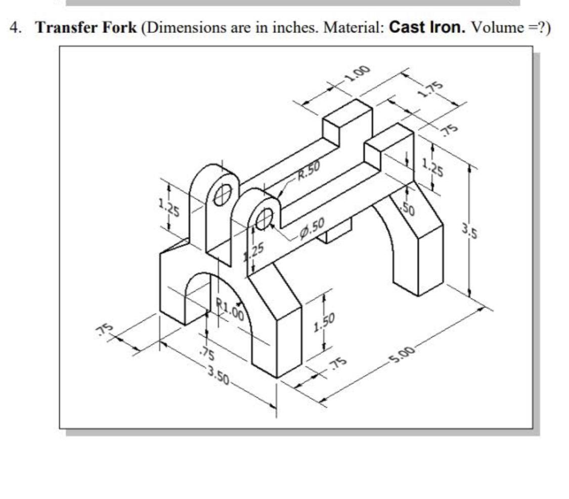

Hello i need help with the drawing chapter 4 question 4 (Transfer Fork ). I couldn’t finish the whole drawing when i try to make the hole part its not letting me to cut or anything i tried many times. So need help with steps plz thank you. Im new to this Autodesk Inventor. It will help me to learn if anyone help me with it.

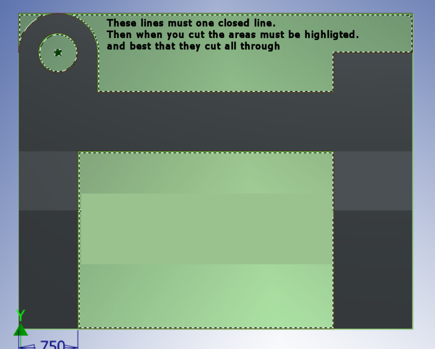

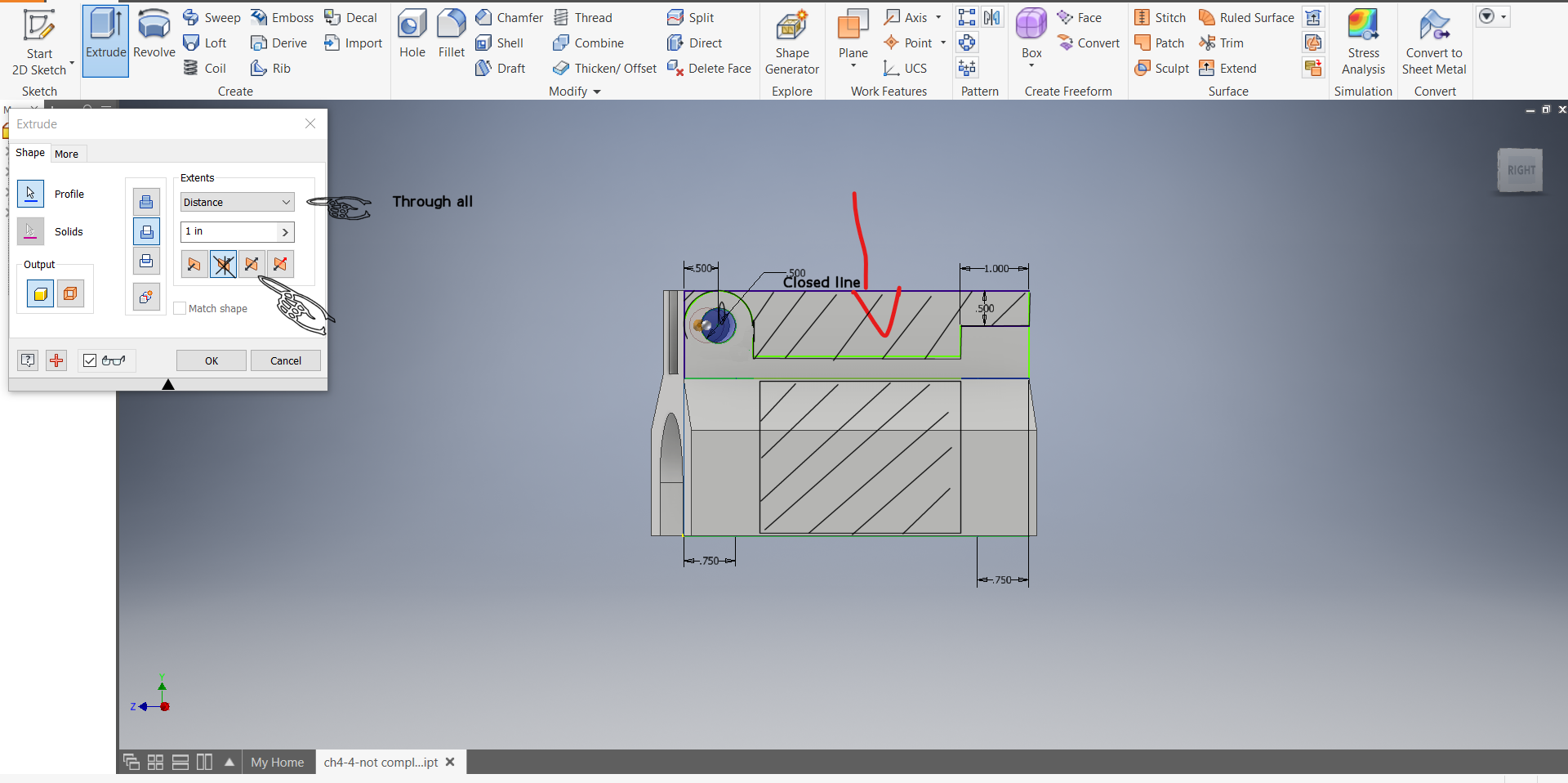

The area you want to Cut Extrude must be one closed line.(right click close line and click on the line till it says line is closed)
then you are able to highlight the areas you want to cut. in your case its best to use the option "Through all"

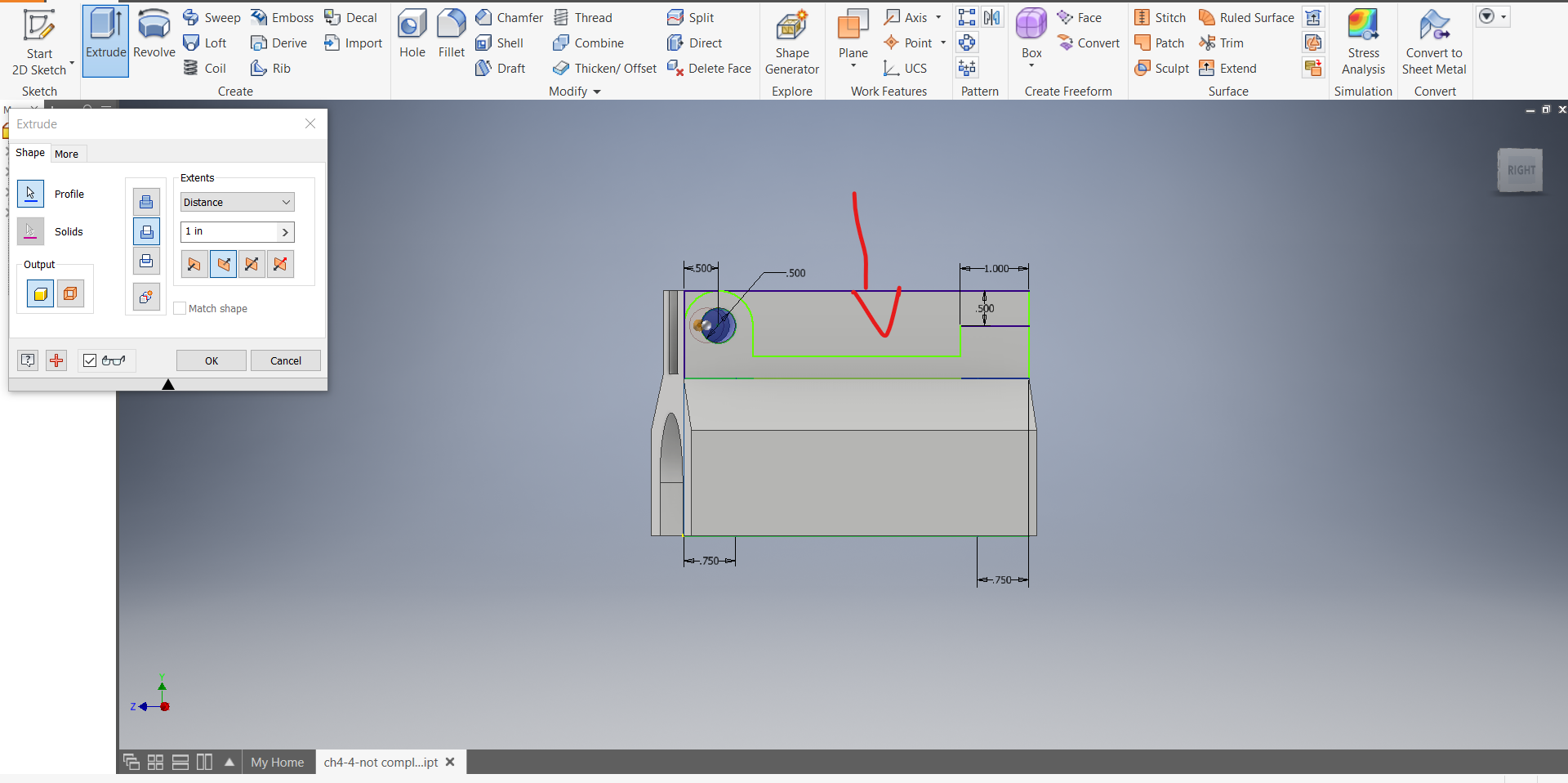

See this drawing i cant able to cut the part only the hole it cut rest dont. plz help me. i tried may times still the same. thank you
