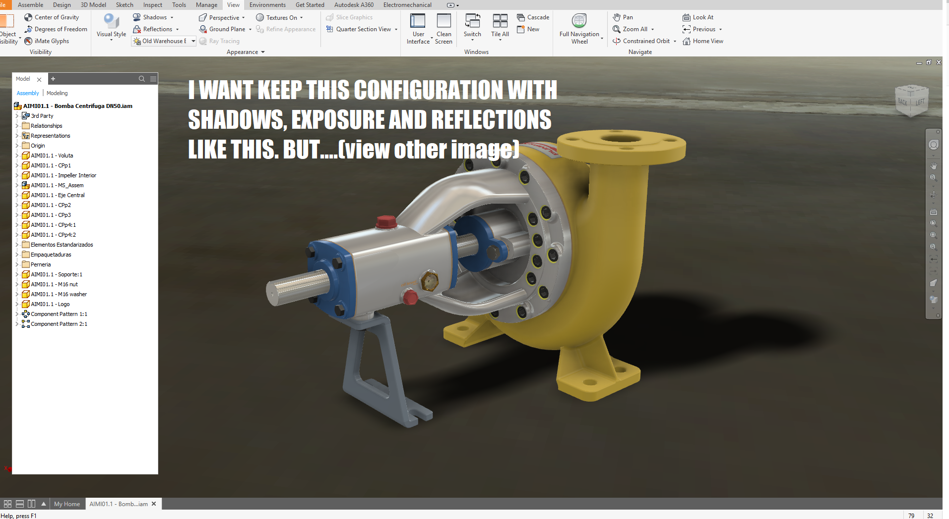

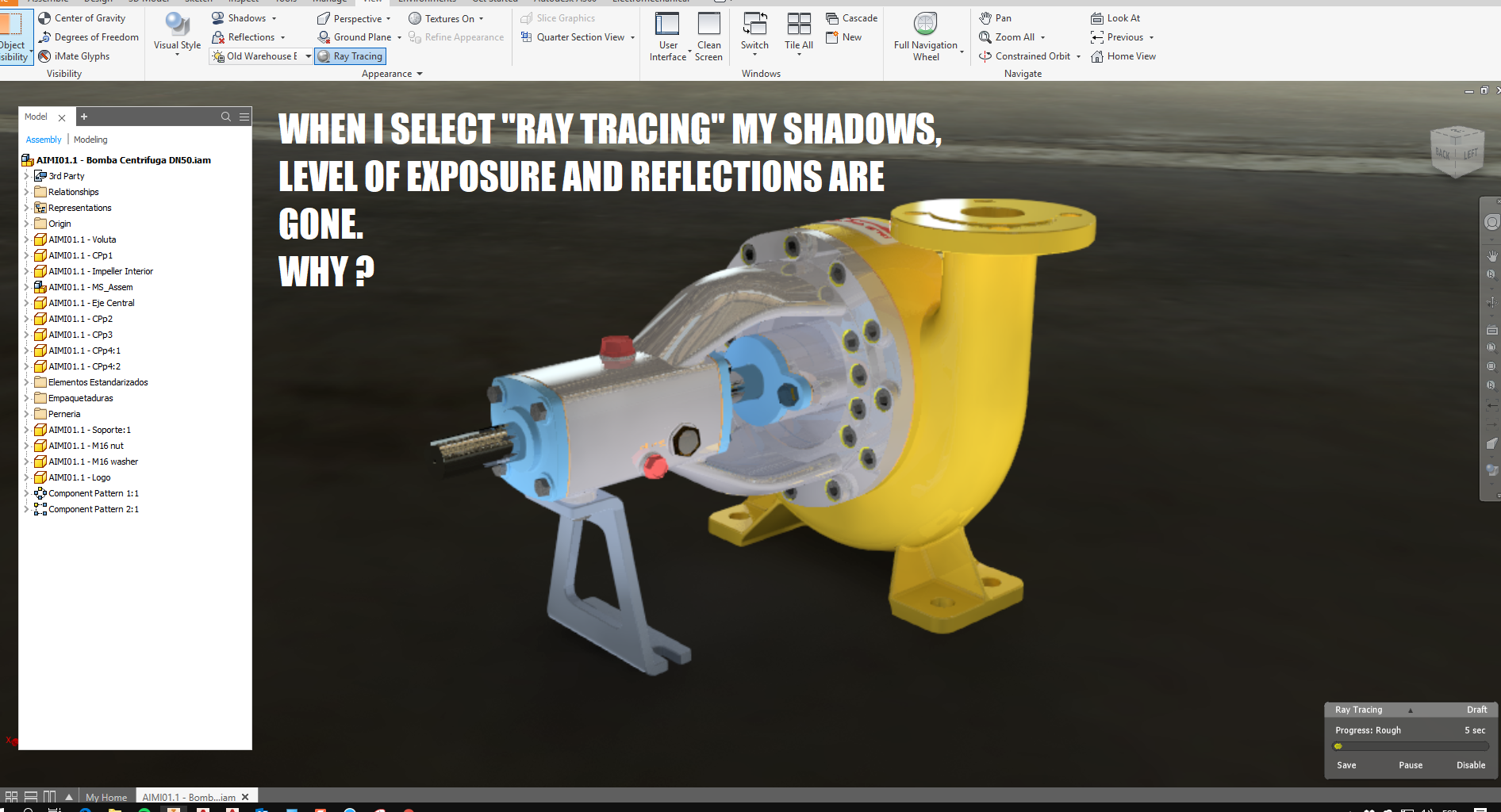

HELLO! On the Visual style tab; For example, I set all my preferences (shadows, exposure, scale) in the window "Standard Style and Editor", but when I choose "Ray Tracing Mode" I lose all my previous configured and it shows me another rotation for shadows, other level of exposure and more things that I never chose.
HOW DO FOR KEEP MY CONFIGURATION AND PREFERENCES ALREADY ESTABLISHED?
Hi Bryan,
if you use ray tarcing, you have to make a choice regarding the background, in your case "old warehouse".
If you open the drop down list, you will see "settings" all the way down.
If you click on it, you can adjust many things. If you open the tab "shadows" you will see that you can completely adjust your shadow there.
regards,
Danny
