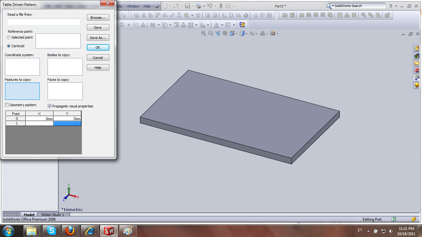

Can't get table driven pattern to work, halp?
Can somebody please show me a tutorial or something? i tried several times but could not figure out why it isint working.
2 Answers
You have to create a coordinate system and select the coordinate system for the "coordinate system" box. Also make sure that you select a reference point or a centroid. So in all to get it to work you need four things: coordinate system, reference point, something to pattern, and at least one table entry for position
