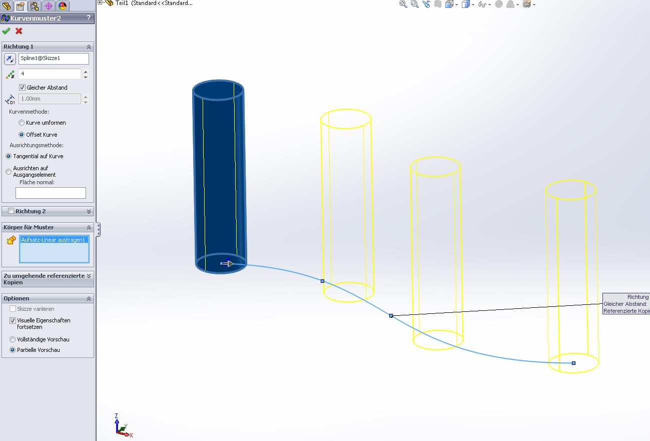

How make a curve driven pattern ? Michał 16 Sep, 2013 01:29 PM Why it can't to create ? problem.JPG part1.SLDPRT 4 Answer f13ba3ad Answered on 16 Sep, 2013 03:50 PM hi....you have to do it with body`s Muster.JPG john fall Answered on 16 Sep, 2013 04:37 PM downloaded your file and it works OK in 2013 no problems check your parameter settings john fall Answered on 18 Sep, 2013 05:44 PM See attached file in 2013 part1_(1).SLDPRT Michał Answered on 16 Sep, 2013 04:09 PM Yes, it works, but I don't know why I can't do it in version 2013. Thank you !
