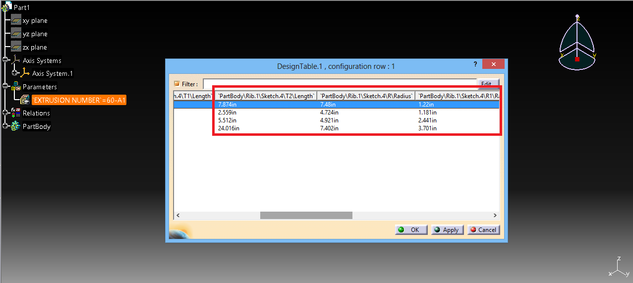

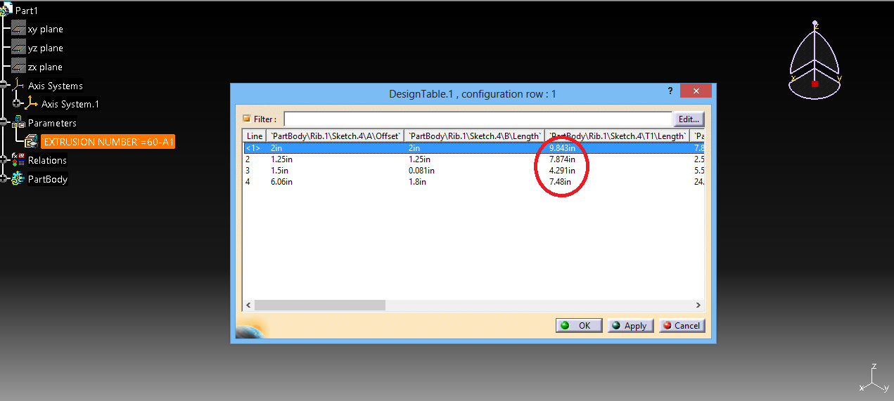

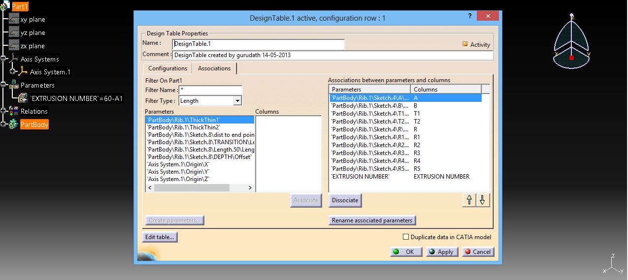

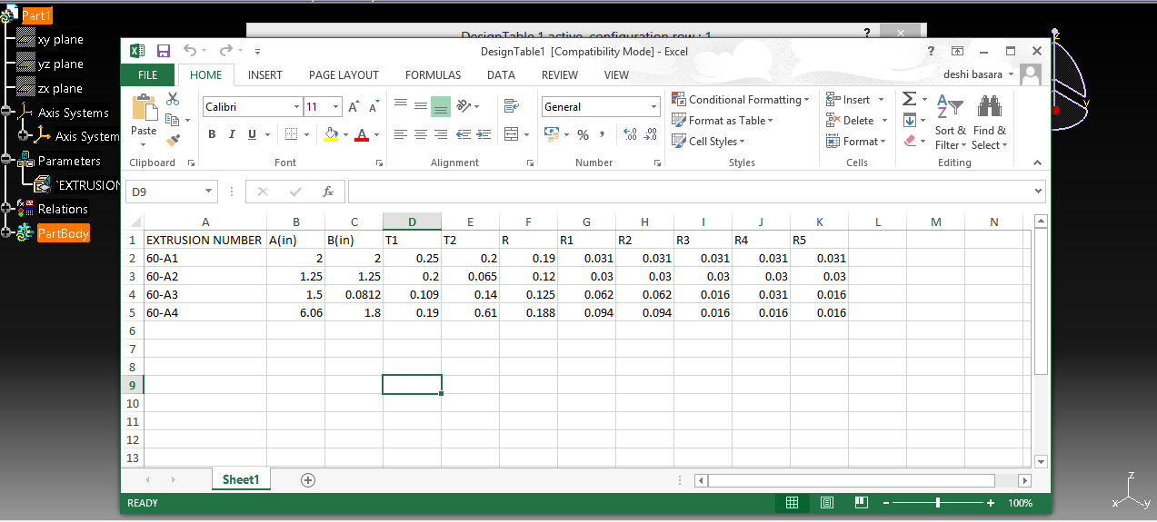

greetings, i'm having a predicament with my model. every time when I import excel spread sheet inside catia the values are no longer the same as I saved in my excel spread sheet leaving me with crazy profiles eventually with error message when I update. what i'm I doing wrong. plz do take a look into my added pics and help me finding a solution.

Did you check units? There is no unit in spread sheet. If you use length parameter you need units also or you must define them in function. (like "value*1mm" or "value*1in")
