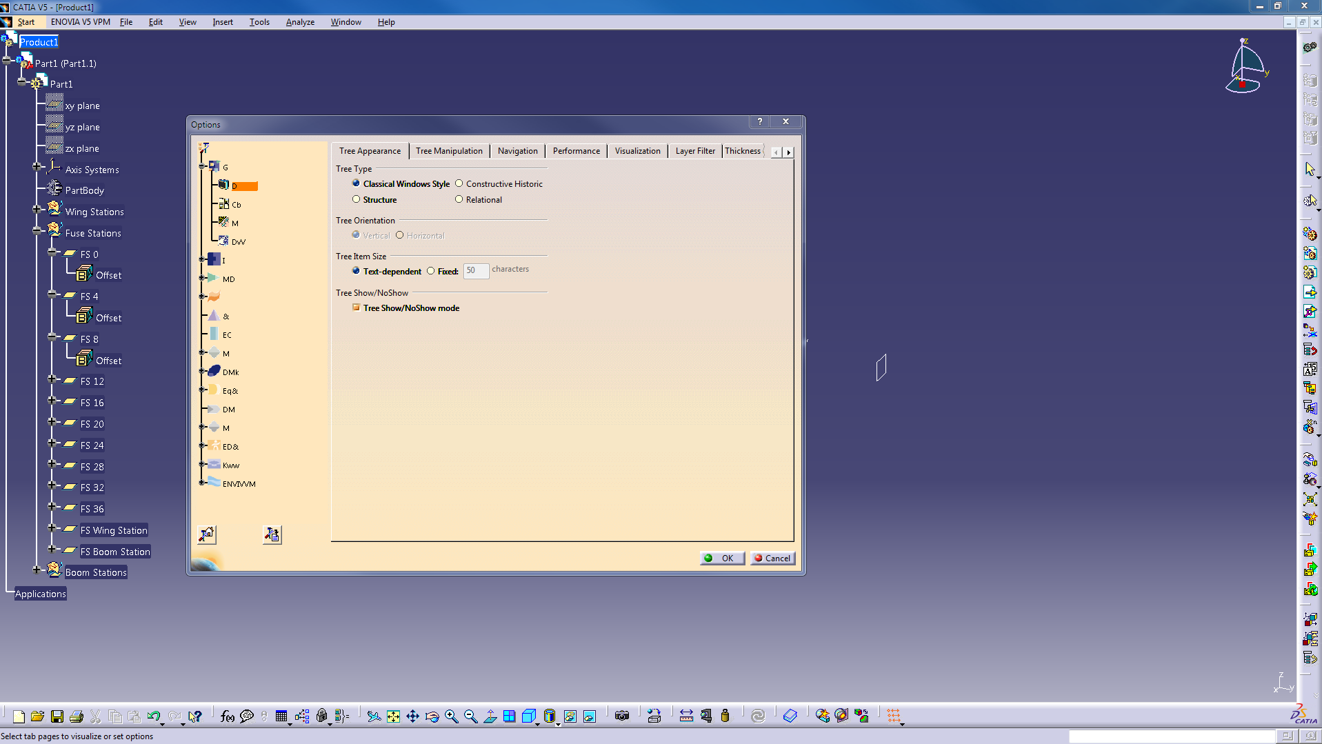

I am using CATIA V5 R21. For some reason the part description text in the specification tree does not appear completely (Eg: If I create a place called "Plane 1" only "e 1" appears on the specification tree.).
Similarly when I open Tools->Options the different option labels are not displayed correctly. I have tried to modify the Tree Appearance -> Tree Item Size to both "text-dependant" and "fixed"; however the problem persists.
Please see the attached file for reference. In the file the plane offset values are not displayed. In the Options dialog box, none of the different environment labels are displayed.

I think you have wrong text size 50? try 8 and choose option text dependent and keep other option as same. and if it does not work try closing and opening application once again.

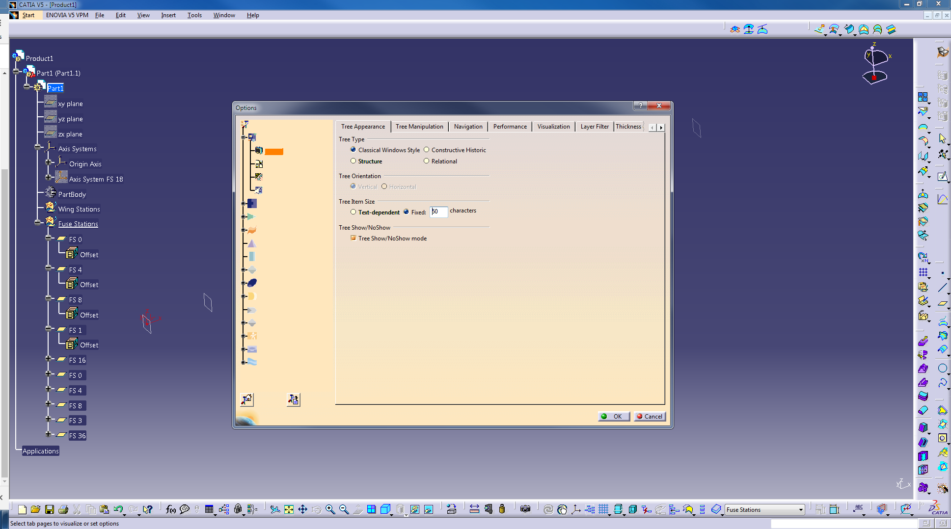

Unfortunately, I already tried the text dependant option (see attached).

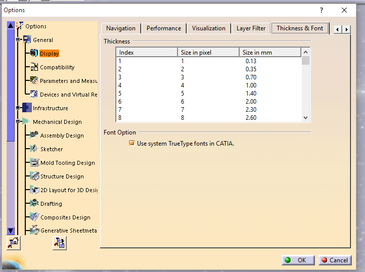

check if this option is active as in image?
I talked to my friend about your problem, this FS means fixed size. so first of all select that fixed size option change the size to 8 as such. then do restart your app. now check the text dependent option and again restart your system. let's see if it change.
