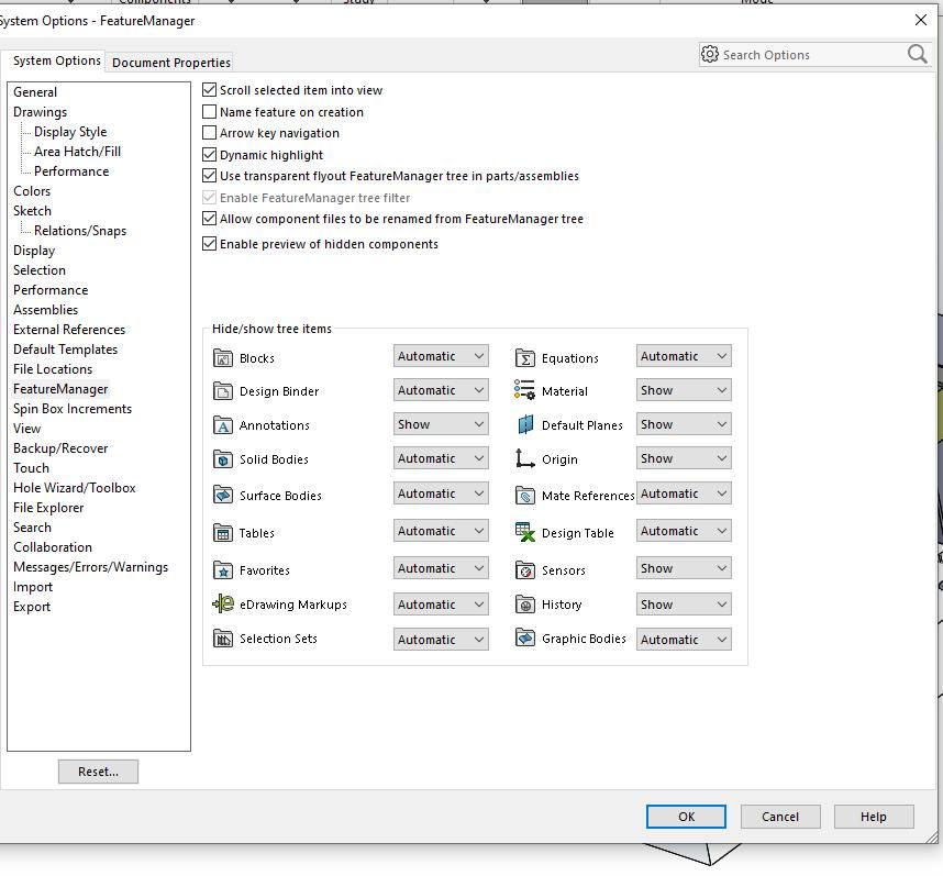

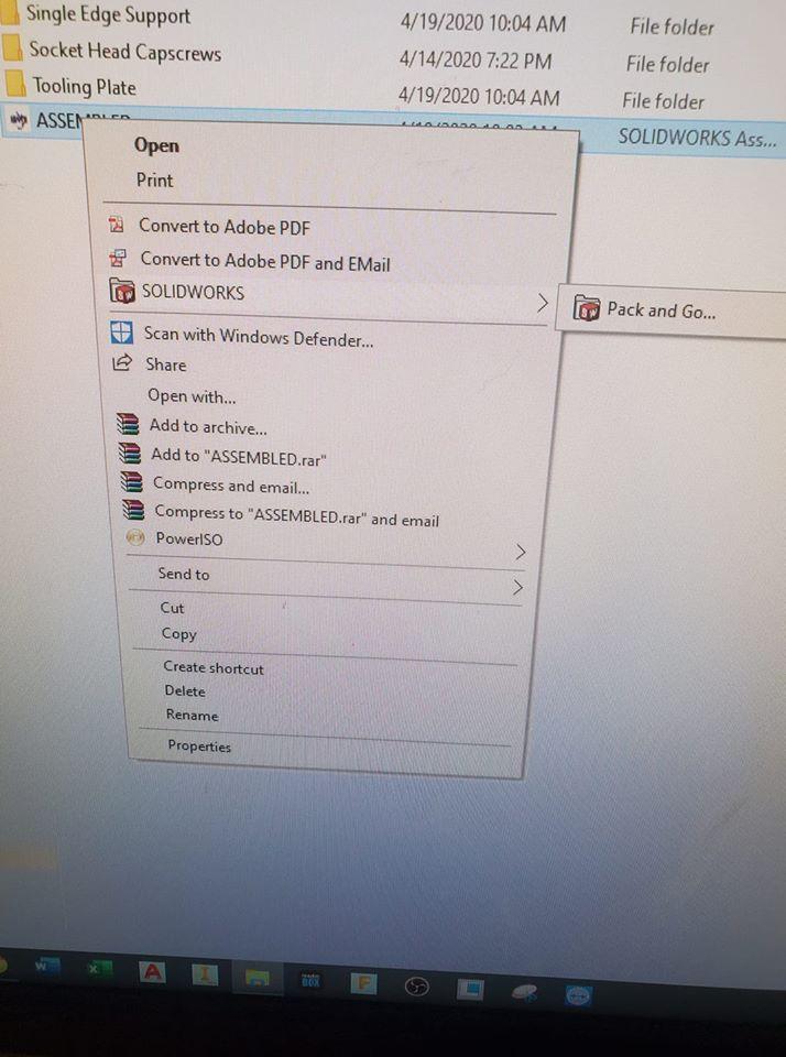

Attached is where I looked to try it. Clicking on the part itself only gives me pack and go and I don't have it in the options.
Open the file in SolidWorks. Then, Save As "copy and continue" with a different name, whatever you like. Open the copy, right click on top level in Feature Tree and click on External References. Then, delete all references. You can send it then to someone who should be able to open it as an independent file.
