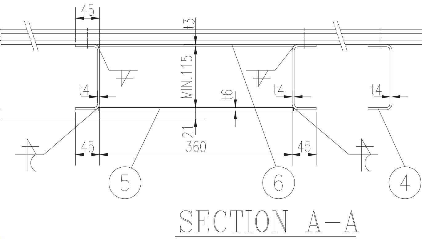

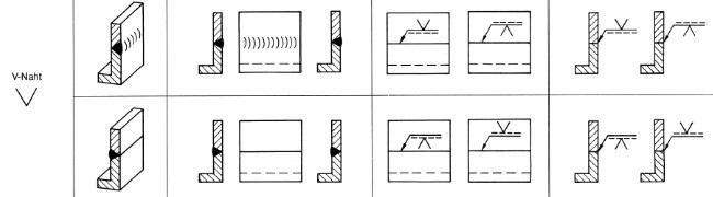

Chinese Weld Symbols? Terry Best 26 Jan, 2021 07:47 PM Anyone know if the line thru the fillet weld symbol is significant, or is that just how they do it in China? I'm not used to seeing that line. Chinese Weld Symbols.jpg 1 Answer AnMay Answered on 27 Jan, 2021 03:40 PM I don't know if there are specific chinese weld symbols, but according EN 22553 which is used for our drawings sent to china for manufacturing this line shows if the weld seam is on the side were the reference line starts or on the back side. EN22553_example.jpg
