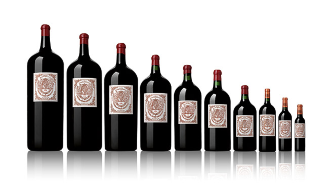

I am trying to get CAD files made for large format wine bottles. *see attached file
We are a local Austin shop and we want to make molds for a local project.

A 6 liter bottle (along with several others) is already available for free in the Library: Wine Bottle (6 Liter)
30L wow. I thought 6L was a big bottle :)
I'd use the 6L bottle in the library as a starting point. Other sizes can be developed from it.

Matching the proportions of the photo you uploaded should not be difficult. Could you label, or otherwise indicate the relative capacity of the bottles in the photo? You are looking to get 5 bottles made, but the image shows 10 variations. Searches online show similar images that range from 7 sizes to 12.
