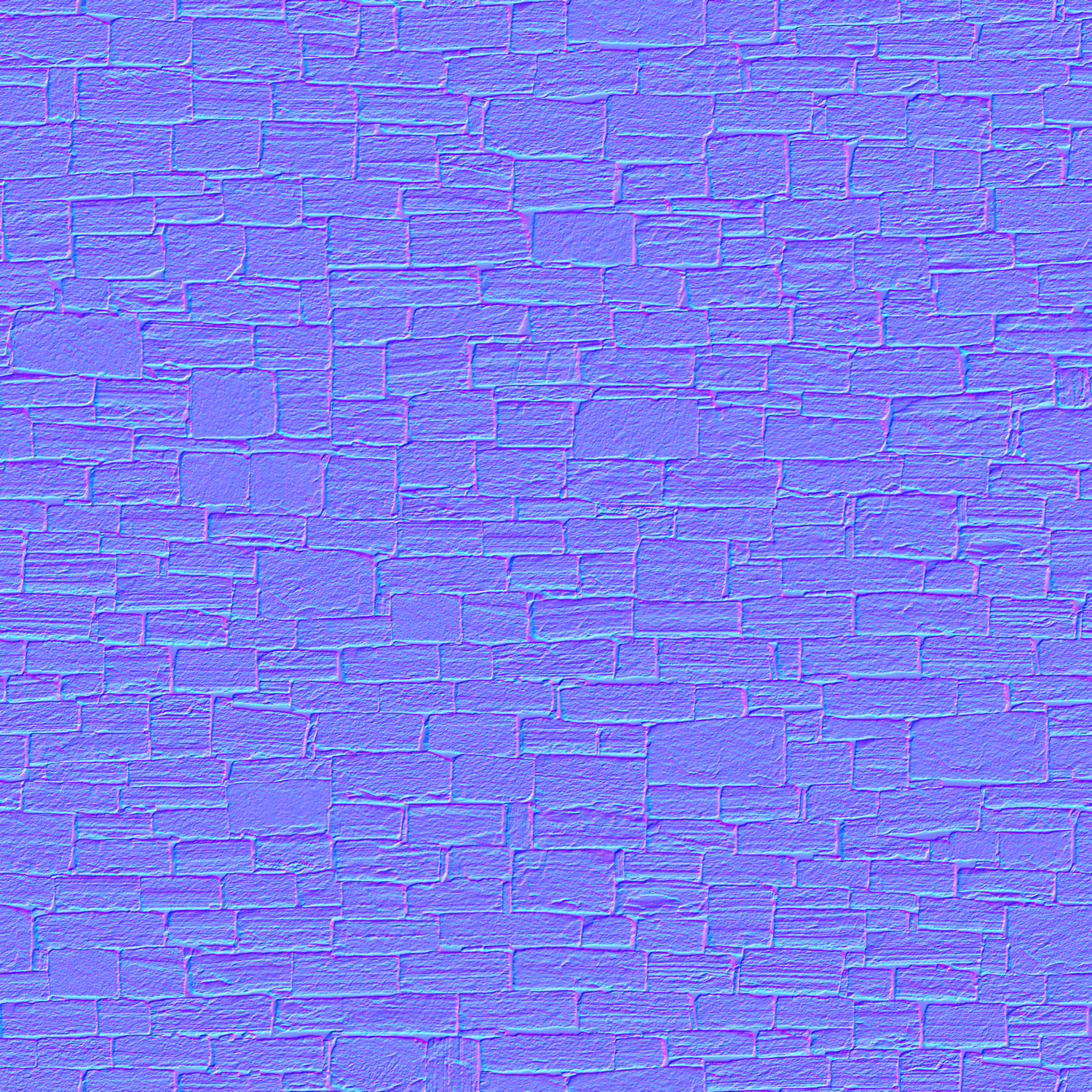

Convert normal map to bump map?
Does anyone have a good way of converting a normal map to a bump map? I am using GIMP but Photoshop would work too.
5 Answer
I've used this method in the past Scott, it's easy three steps http://www.textureshock.com/tutorial2.htm
Based on Danny link (http://www.textureshock.com/tutorial2.htm), adding step by step tutorial:
Answered with a tutorial: https://grabcad.com/tutorials/convert-normal-map-to-bump-map
There is also a software http://www.crazybump.com/
Haven't tried that though as it needs a 32bit win:)
There's also http://www.quixel.se/ NDO just launched version 2, integrated right inside Photoshop.
I just purchased the Shadermapper, it was like $40 and worth it. Befor that I was using SSBump and that did well for me it is freeware.
http://shadermap.com/home/
http://ssbump-generator.yolasite.com/
