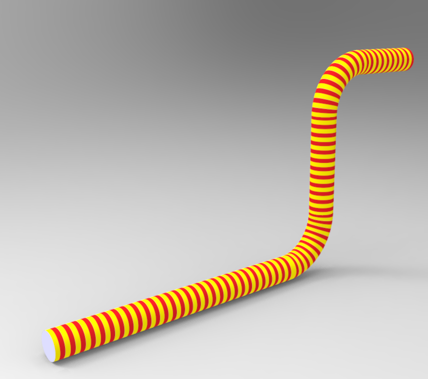

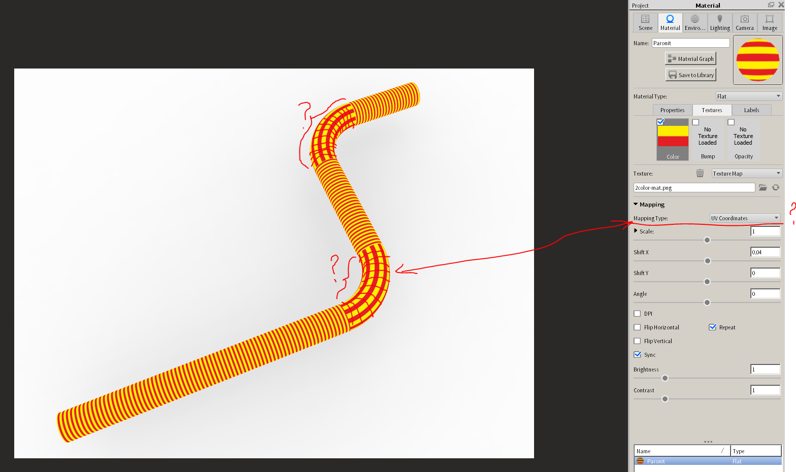

Please help me! How can i set texture mapping in Keyshot so that the stripes are perpendicular to the curve pipe axis. (In the pipe bend texture are parallel)
Please see attached image.

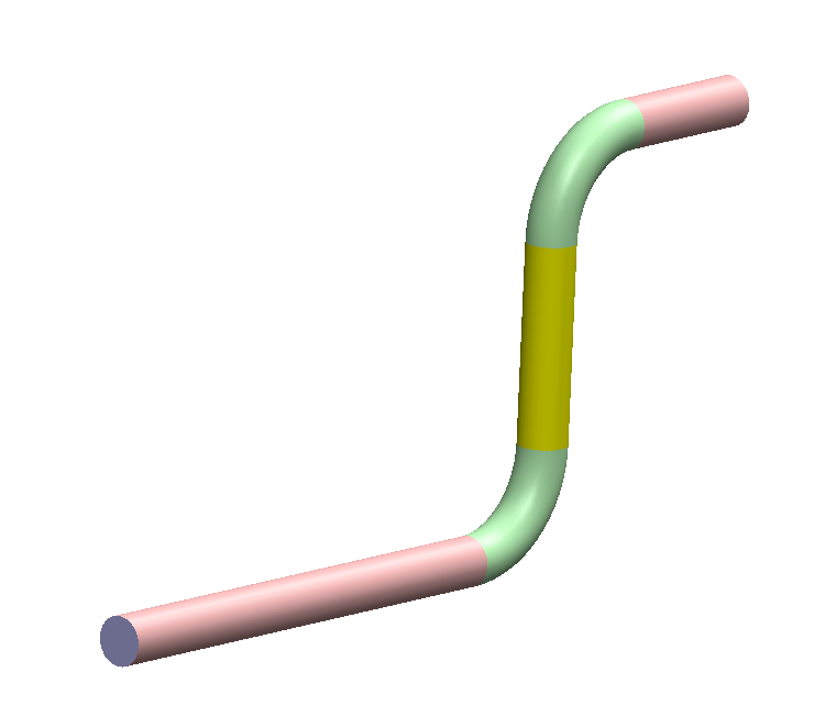

I split your original model up into several distinct sections with different colors applied in SOLIDWORKS. I then exported the model as a 214STEP format so Keyshot will see the colors.
For the horizontal and vertical portions I applied your texture with planar mapping. One of them will need to be rotated 90° to look right.
For the curved sections I used UV mapping. You'll have to play with the size and position sliders to get a better alignment than I did, but I think this will work.
Images and a segmented step file are attached.
