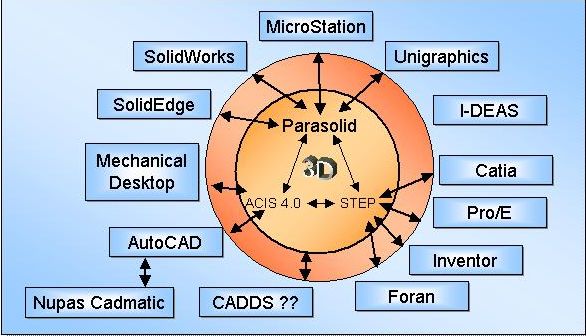

@ abdullah
in converting files from one CAD-System to could just oriented on the picture in the annex.
Cheers Bernd
