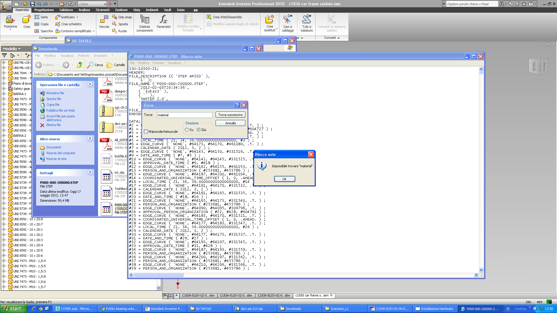

Thanks Alexander,
I have checked the file to import to Solidworks, this does not have information about material, you can open the file using "notepad" in accessories and search the word "material". In this case, the file doesn't have data about materials so Solidworks or any CAD software will never open it with this information.
I will check if I modify the file adding material information , Solidworks can used this information on its model.
I will tell you later!!!. By the way , try to ask Aratrum to attach its original format and We can get all the information .
Bye.
