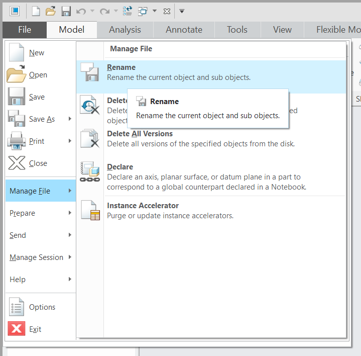

Hi,
Rather than renaming parts in your folder you should have used the "rename" option in Creo (File > Manage File > Rename). You would need to do this for each individual part.
All the best with it
when you rename of part that time you have open all assembly where use of this part. then you cad change part name.
