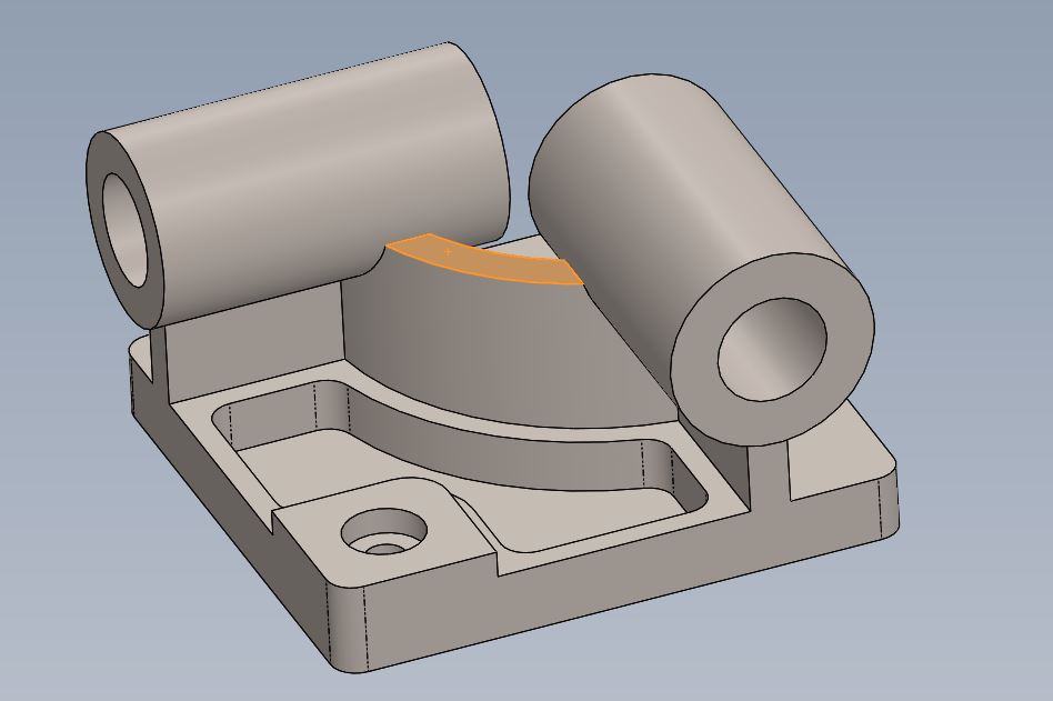

CSWP example sample question - Keep getting wrong mass asnwer
For this question for example 1 in CSWP example sample question, the first part, the correct mass is apparently 14207.34, however I keep getting 14140.33 grams. All my dimensions seem correct. Any idea whats wrong?
2 Answers
I'll give you two hints.
1) It's the unnecessary equation driving this surface, (choose a different sketch plane and go with the 'given' dimension from the exercise)
and 2) the part is not yet complete (missing features).
In general, you're better off to "link values" of a dimension to a global variable rather than make an equation to link the value, I was able to delete every equation in your model and link to global variables instead. I guess the end result is the same but you end up with a bunch of unnecessary equations.
Let me know if you need better hints ;-)
edit: You're working it faster than I'm replying. You've found the missing features, now the problem is in that same sketch as the surface that had the wrong height.
Try to make sure you're duplicating the dimensions shown on the exercise to keep things easier to diagnose.
My bad, I fixed one more part that had the wrong height, namely in Boss Extrude 2, but my mass is now 14199.84 and still not 14207.34.
