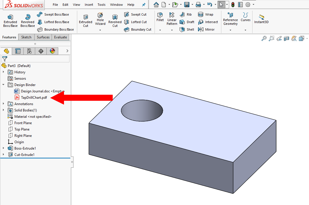

2. Use the Design Binder in the Feature Tree. It might be hidden by default, but all sorts of stuff can be added to the binder, or added as additional shortcuts. Attached is a screenshot of a drill chart added to mine. I saved the part template with the file so it is always there.

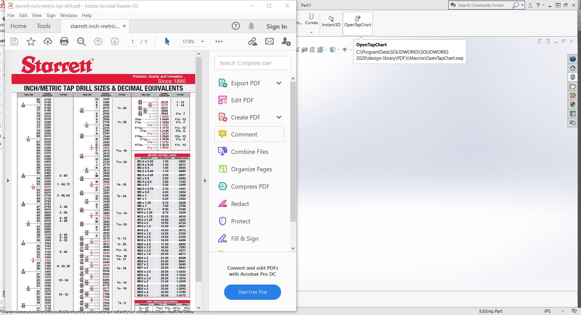

This is how I did it. Not sure if this is right, or a total bodge job. I started by doing the same thing I think you are currently doing and created a Library folder with the PDF's in it. Then I made a Macro (copy of Script attached) then plotted that macro to the main ribbon. Click the button, Tap chart Pops up.
A Walk through is attached, but a bit confusing. Let me know if you need more information.
