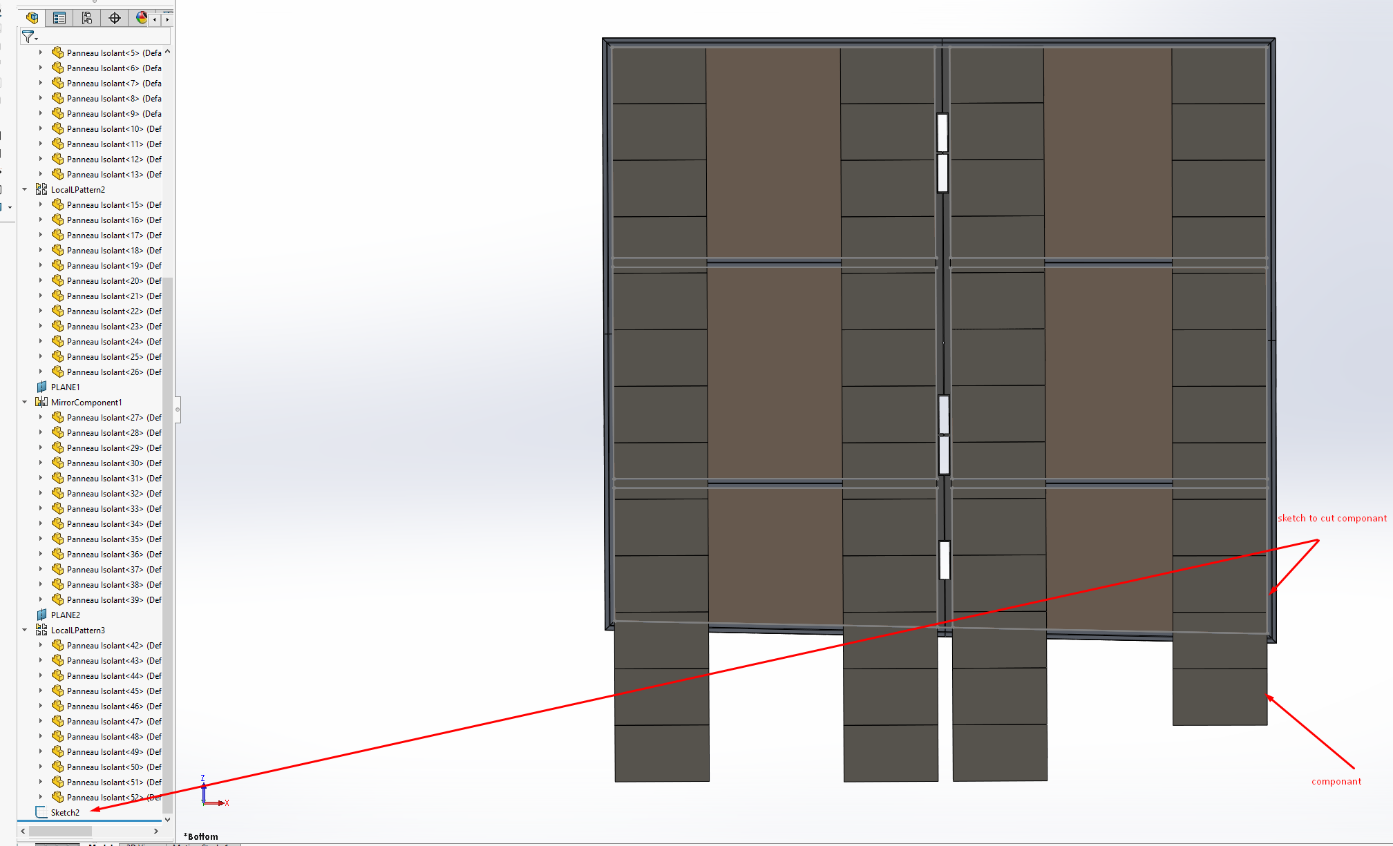

Hello,
I'm strungling to cut pannel at assembly level. The frame got several configuration and the number of panel is not the same from one config to another but I need to cut them and get rid of the extra panel on other configuration.
I do have more than 50 configuration for the frame so I would like to avoid to do it manually one config after another one.
Any idea? Thanks

Here are two options to avoid manually cutting panels in each configuration of your assembly with over 50 configurations:
Assembly Level Cut:
Use the "Assembly Cut" feature. This lets you create a cut feature within the assembly that affects all https://www.health-insurancemarket.com components it intersects.
Suppress Panel in Specific Configurations:
Create a separate cut feature for the panel.
Use "Configuration Specific Suppression" to suppress the cut feature in configurations where you don't need the panel cut.
Both methods achieve your goal without manual editing in each configuration.
