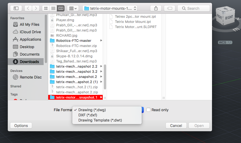

I have AutoCAD 2018 on my MacBook, but I am unable to download files from GrabCAD to make it easier to show my robot design for my robotics team. Please help quick, I need this design done before the new year. Thank you.

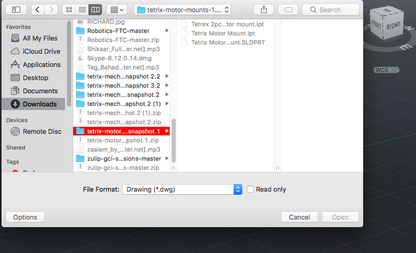

So, from your screenshot I can see that firstly, downloads themselves are working fine, but you are trying to open Autodesk Inventor files (.ipt) in AutoCAD, but have "File Format" in the open dialog box selected to be .dwg (AutoCAD).
On your screenshot, in the bottom, there is a select box labelled "File Format". Change it so it says Autodesk Inventor (.ipt) or "Other"/"Any" (if possible – I don't use/have AutoCAD myself – but it should work this way). That should allow AutoCAD to open Inventor files.
This should work the same across all (native) applications on Mac (as long as the application supports the file format you are trying to open).
Refer to AutoCAD's documentation here about opening/importing Inventor files: https://knowledge.autodesk.com/support/autocad/learn-explore/caas/CloudHelp/cloudhelp/2016/ENU/AutoCAD-Core/files/GUID-A6485DF3-DAE5-480B-BB66-69EA2E2E3F58-htm.html
Alternatively, you can try uploading the files to GrabCAD Workbench (not necessary if you got them from there anyway) and using the "Download As" functionality and selecting AutoCAD as the format.
