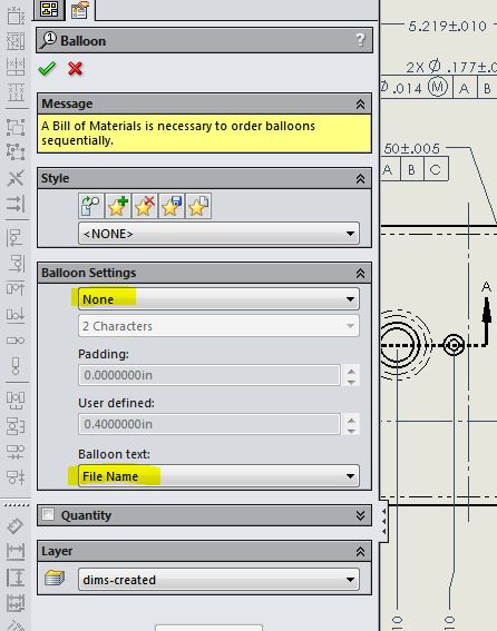

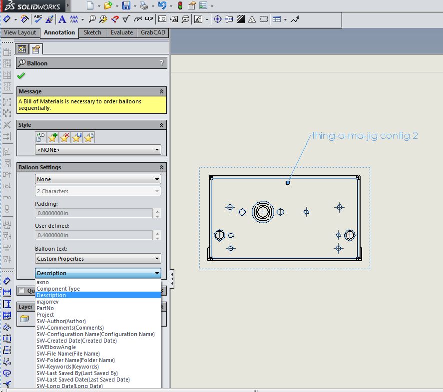

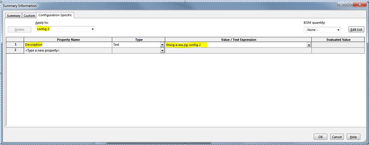

I have to make one single drawing out of the assembly of some parts, that each of them have different configurations. I need to use a Note to indicate the name of each part, but the problem will be that in the Note setting, you can hyperlink it only to the file name or material or description, but not the configurations, so I could not make a distinction between these parts in this drawing so far.
Is there a method to do so ?
2 Answers

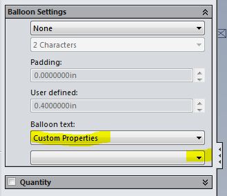

Try using balloons, set the balloon type to 'none' and the balloon text to 'file name'. You can also link in custom properties and a bunch of other things.
