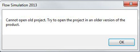

In our school we use the Student Engineering Kit 2013 Sp2.0 and the same version is installed with our students at home. After making a flow analysis they wanted to present the results at school but when loading the analysis results i get the message "Cannot open old project. Try to open the project in an older version of the product". (see screenshot)
Anybody an idea how this is possible?

It actually looks a clear case of making a model/Analysis in newer product and trying to open in older version. I think it is creating prob due updates. maybe.
hello, we found the answer and it was a little surprising. The problem was that a student had installed a more recent service pack and that gave a problem. SolidWorks Flow Simulation there is highly sensitive because of its result files
See, I told you it could be updates prob :)
