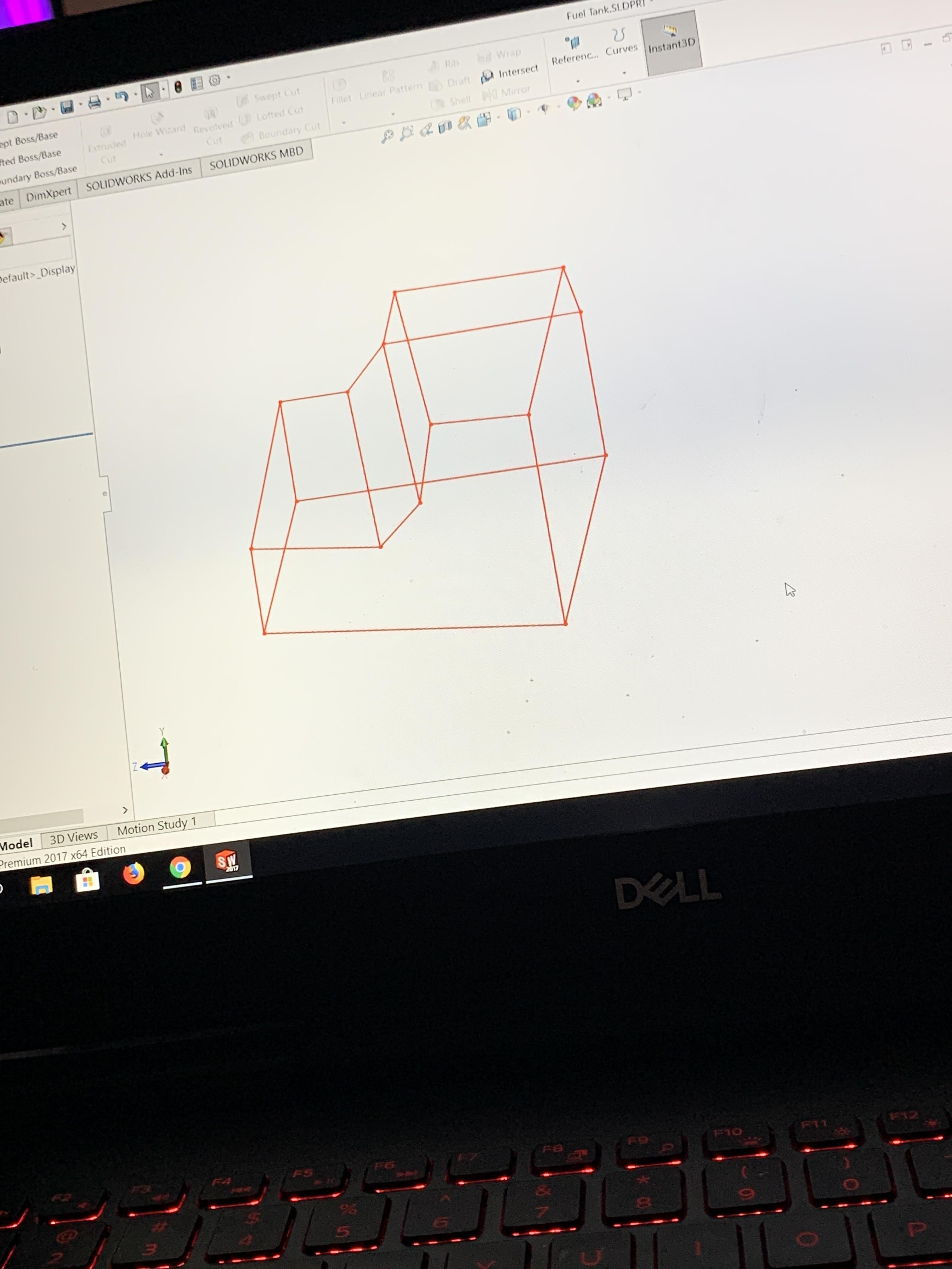

I just recently started a job that allows me access to solidworks. I'm currently designing a fuel cell for a race car. I am having some issues that I am hoping someone can help me with. I made a cardboard template and now I'm using the measurements from that and creating it in solidworks (kinda) I would like to sketch it out then create a 3D model so I can find out how many gallons of fuel it can hold, the weight and so forth. I started the sketch in 3D sketch mode and got it pretty close (I think) but Im having an issue creating a solid object out of Aluminum. Any suggestions?

Photos taken of monitors are terrible. Actual screenshots are appreciated.

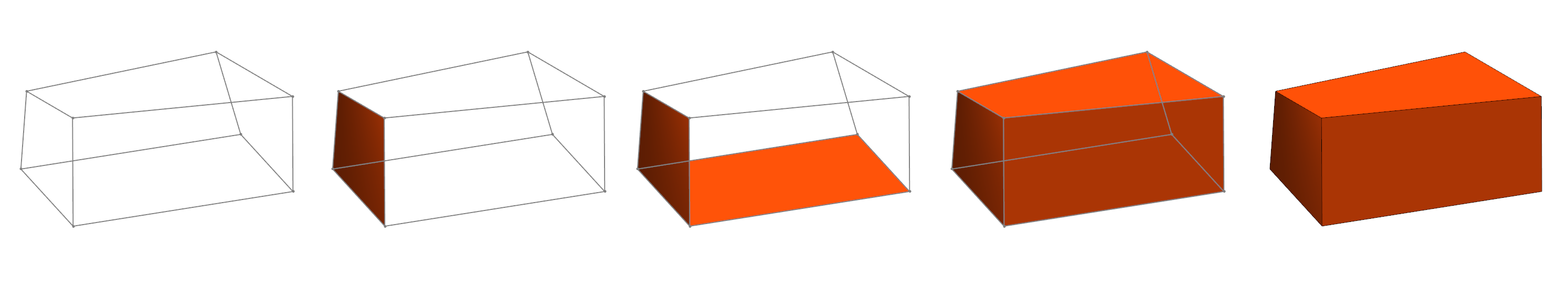

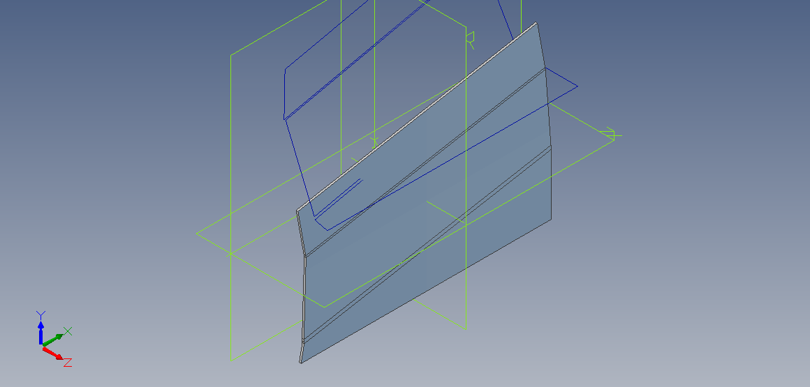

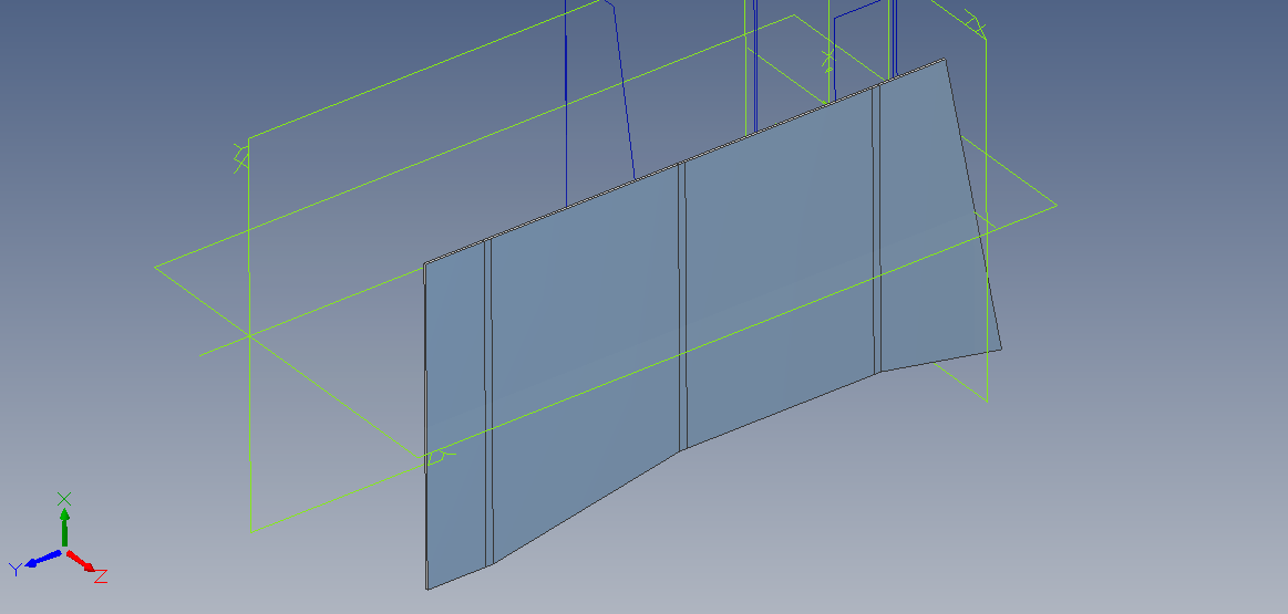

I attached an image showing a sequence of converting a 3D sketch into a tank.
3D sketch, then use Boundary surface to add in the walls, Then knit all of those surfaces together to form a solid.
That's either the volume you need, or you'll need to shell the resulting part to give it a wall thickness so it represents the tank.
There are other ways to do this, but I'm guessing you just have a single 3D sketch. So Boundary Surface is good because it allows use of the Selection Manager to choose individual segments of the 3D sketch to form surfaces between.

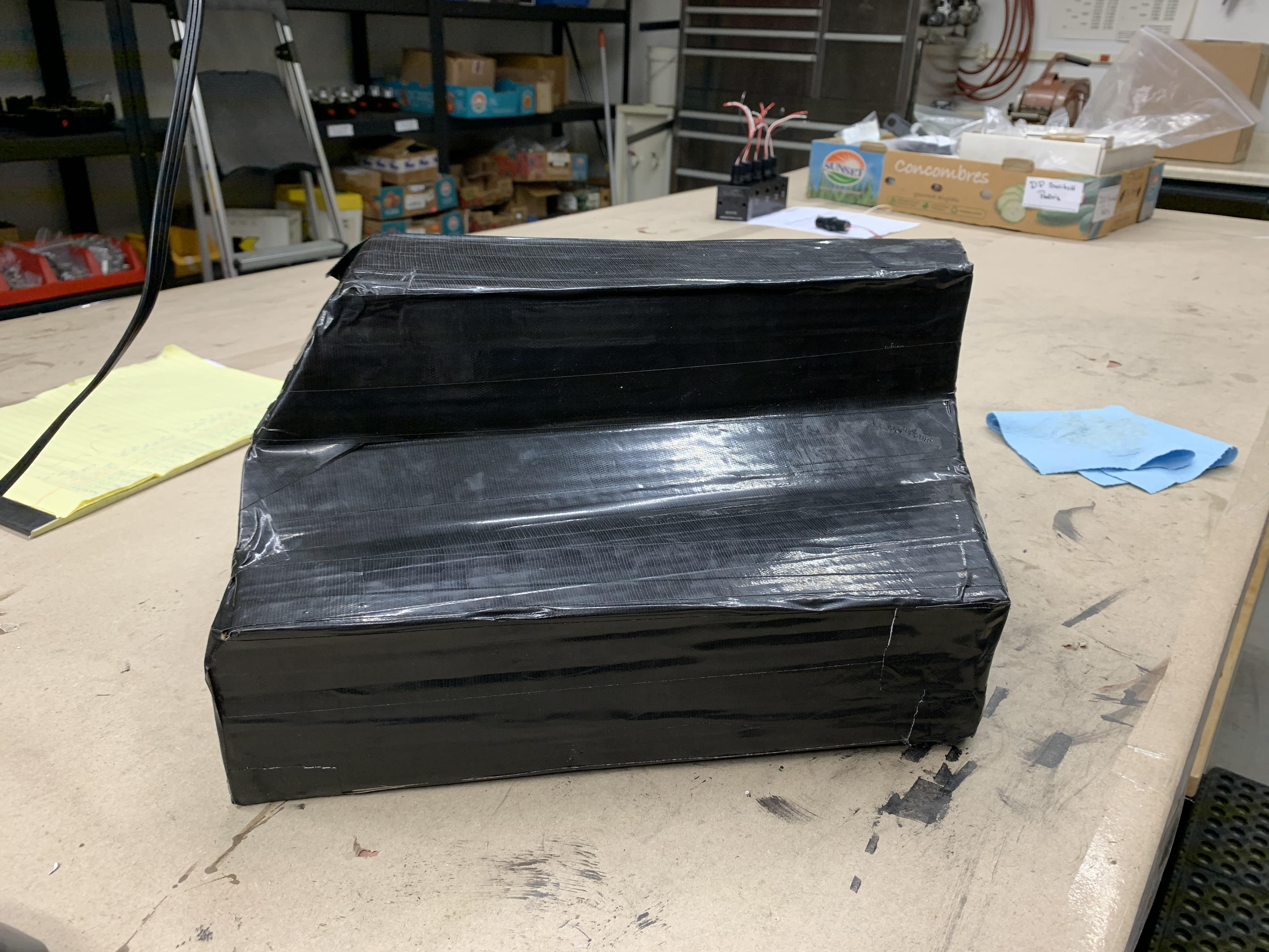

Here is my cardboard model of the fuel cell. As you can see its shaped a little weird to get the best fitment in the car.

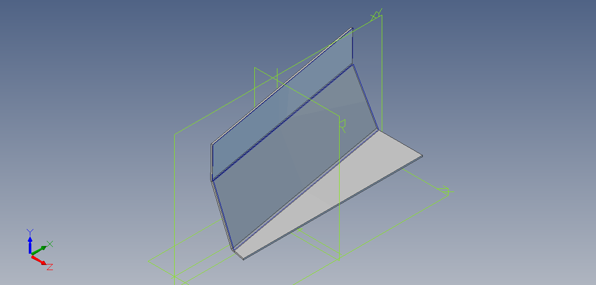

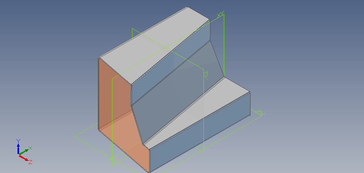

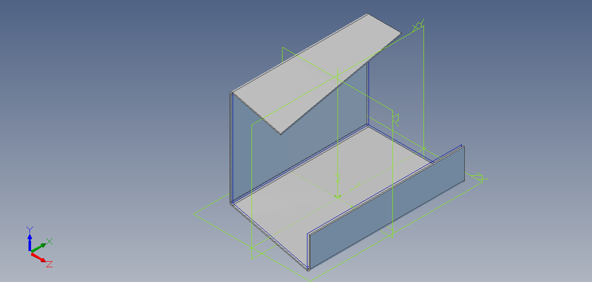

The basic CAD workflow I would use if the desired outcome is to end up with an actual fuel cell of known volume that you can place into car is this :
Step 1. Use cad to model the volume of fuel. This lump of fuel can be given real world properties e.g relative density so that the mass for the full fuel load, center of gravity, and much more useful data can be extracted from this model.
Step 2. Once you have a fuel volume that fits in the available space we create sheet metal parts to contain our volume of fuel, making use of our knowledge of the tooling we have so that the pieces we design can be bent with this tooling in the press-brake we have and we keep welded seams to the minimum.
Step 3. We use our CAD tools to produce a set of drawings to manufacture the fuel cell. Because we used the sheet-metal tools in our CAD package producing the flat developed shapes to cut out are created automatically. We then bend the parts into the required pressed parts and weld them together.
The attached images give an indication of this workflow. The actual fuel cell will also have the required fittings, inspection hatches and the like that you will need in a real fuel cell.

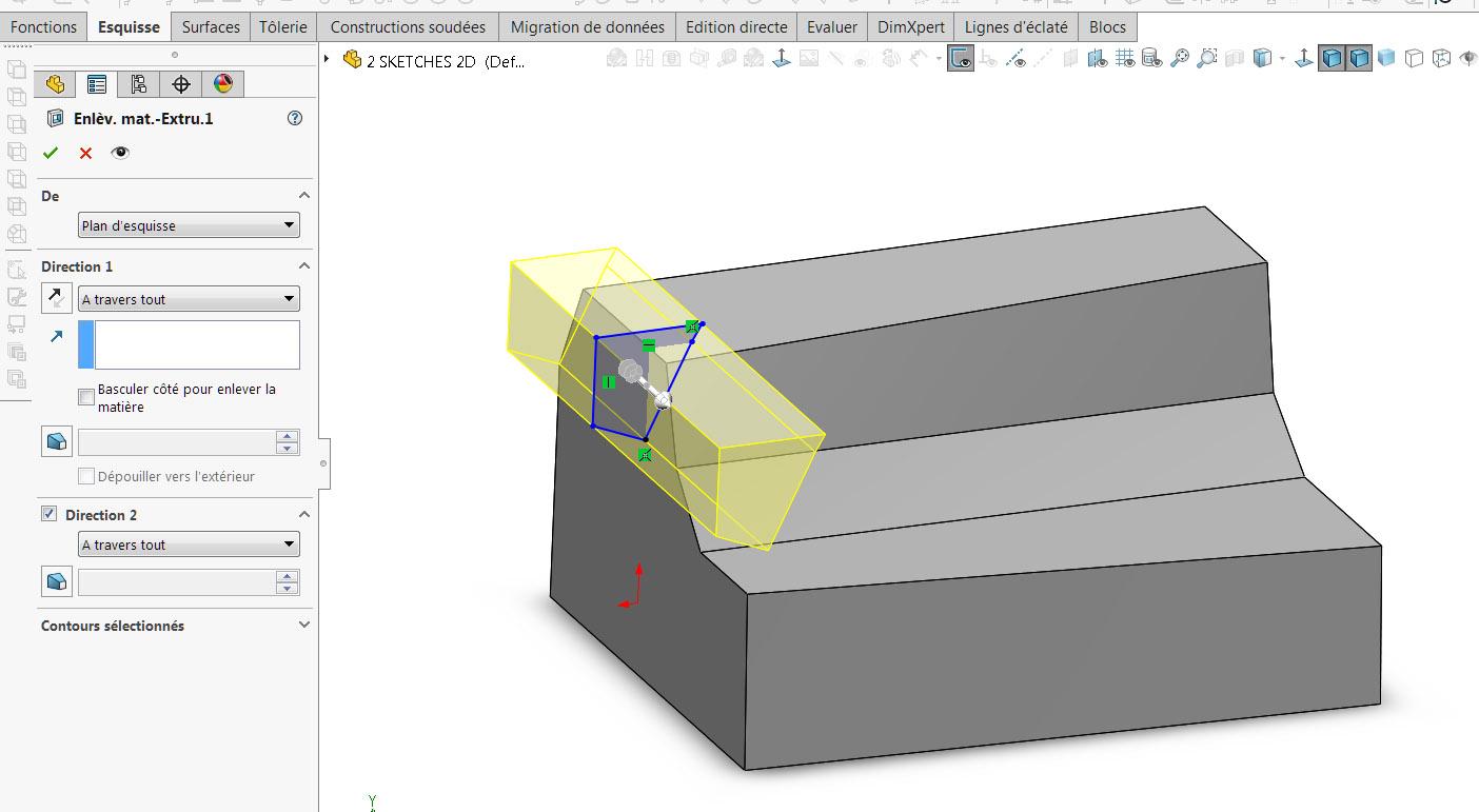

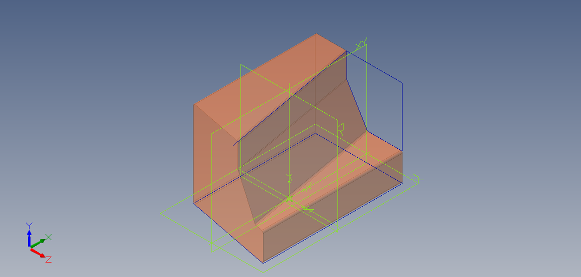

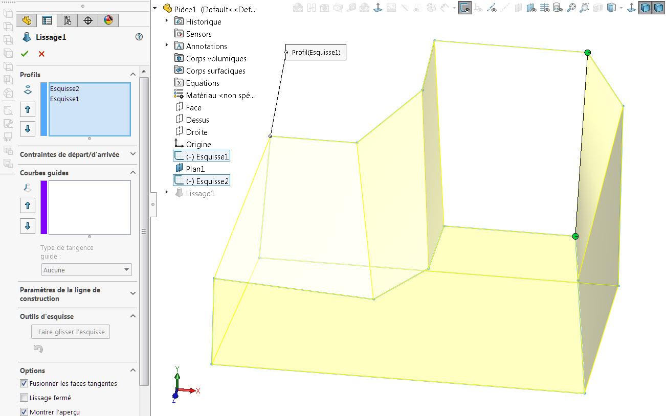

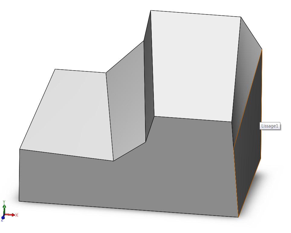

No need to sketch 3d which are complicated when we have no references plans. On the contrary with just 2 sketches 2d and a smoothing we can easily model this form.
In the end you only have to find the appropriate plan (s) to do a removal of material. (Approximate shapes)
