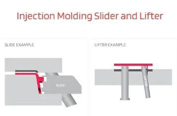

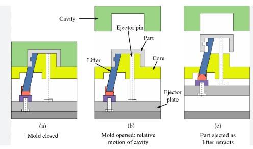

Could anyone explain to me the function and differences between slider and lifter mechanisms in an automotive plastic part, please. Maybe some example 🙏🏽

Certainly! In the design of injection molds, both sliders and lifters play crucial roles in the opening and closing process. Let’s explore their differences:
Slider:
Function: Slides along a guide rail to change the shape and size of the die nut, enabling demolding.
Movement Direction: Moves horizontally or angularly within the mold cavity.
Applications: Ideal for horizontally oriented undercuts, side draws, and interior cores/details.
Complexity: Typically more complex in construction to guide movement.
Actuation: Commonly driven by hydraulic or electric means for linear or rotary motion.
Lifter:
Function: Utilizes a tilted top plate mechanism to push the lifter upward or downward for product demolding.
Movement Direction: Moves vertically up or down within the mold cavity.
Applications: Best suited for vertically oriented undercuts and interior cavities/pockets.
Complexity: Usually simpler in structure, focusing on vertical up/down movement.
Actuation: Often driven by mechanical mechanisms like springs and top bars, ensuring reliability and stability1.
For an automotive plastic part example:
Imagine a car dashboard with intricate interior details. A slider could create the textured surface of buttons, while a lifter might handle the vertical undercuts around the air vents. Each mechanism contributes to the final part’s functionality and aesthetics2. 🚗🔧
