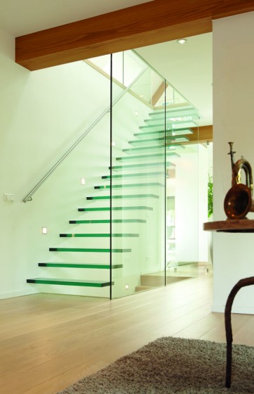

Hi, I want to draw a glass stairs only attached at one side. There are several ways to attach this glass plate, does anyone have the principal of this clamping?
See picture: I want to do this but on the wallside a stainless steel stringer with a maximum width of 50mm with a glass clamping divice inside.
there will be huge bending moment near the attached surface as it will act as cantilever.not a good idea to support only on one side.
