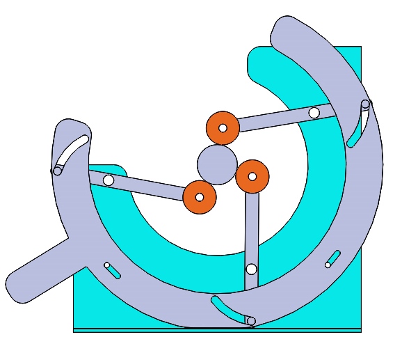

Is this clamp really working?
is this clamp really working?
I would like to move the ring manually.

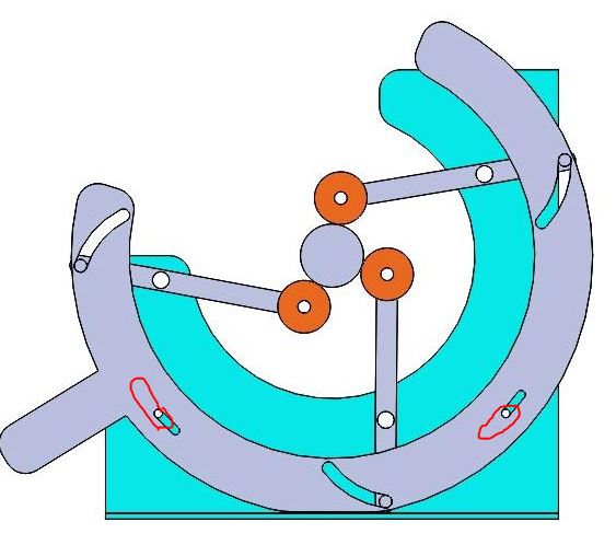

I don't think the ring can move in this configuration. I suggest moving the slots as shown in my attached image
thanks for the video, proving that I was wrong (again).
So what is the purpose of this device? looks like it is self-centering.
