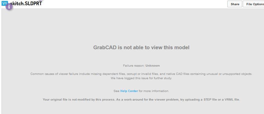

[HELP] how to view Solidworks 2018 (.SLDASM) and (.SLDPRT) project 3d files on the workbench ?
when i upload a solidworks2018 3D file and try to view it i got a message "GrabCAD is not able to view this model" and if it's a solidworks2017 3D file it works fine and can view it.
so is there any help to support the 2018 files ?? cause i need it asap
GrabCAD's built-in 3D viewer doesn't support SW 2018 files, yet...
You can upload STEP, STL, IGES, etc. files of your model instead.
You can check the supported file formats here:
https://help.grabcad.com/article/64-3d-viewer#file_formats
