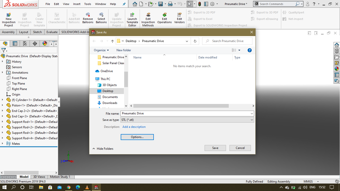

how to view 3D .sldasm without solidworks
i try to convert it in stl but it shows every part of the assembly differently not together.

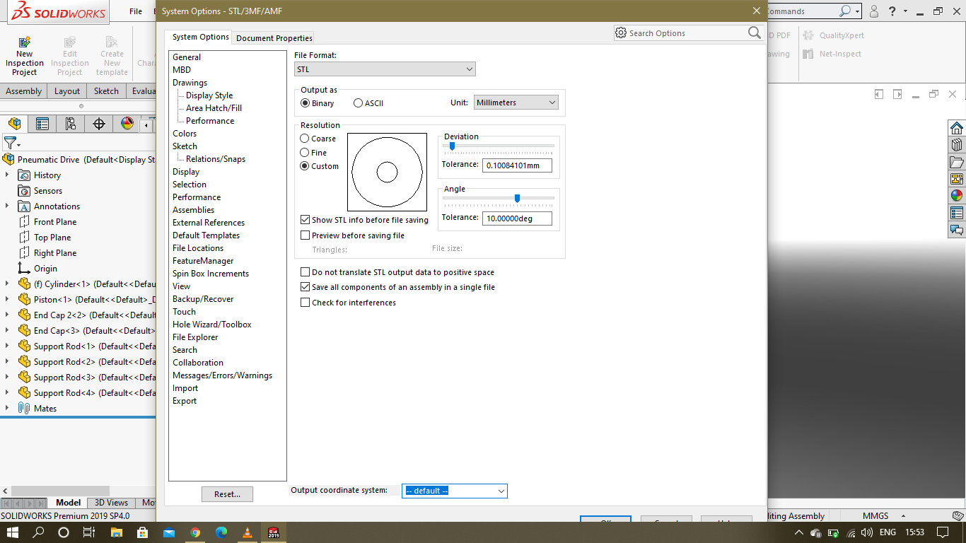

while saving in stl in the save as window go to options and select save in a single file
