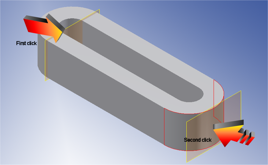

Not sure if anyone knows how to do this but I was wondering if anyone could help me out with this drawing. Here is the actal pic of what i'm doing: http://i47.tinypic.com/5zi807.jpg
I included the model also. I'm stuck on the part where there is suppose to be a hole drilled through.
Pic of model: http://i45.tinypic.com/i50kdv.png
I had the whole right now its suppose to be on the other side of object but I didn't know how to move the xy plane. Could someone try to do it?

First of all just click on a Origin plane then click on the round surface where you need the plane. then you can sketch your hole on the new plane.
