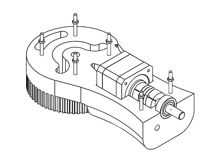

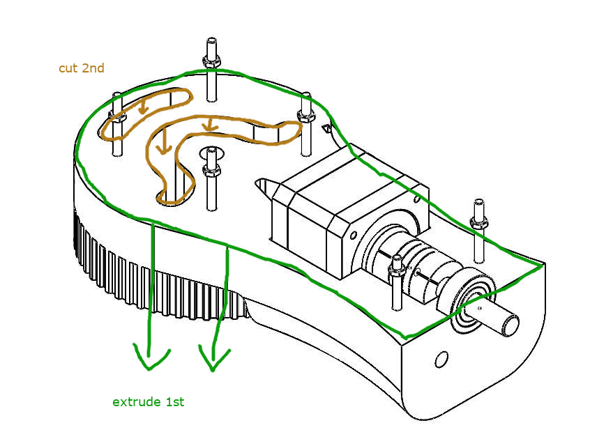

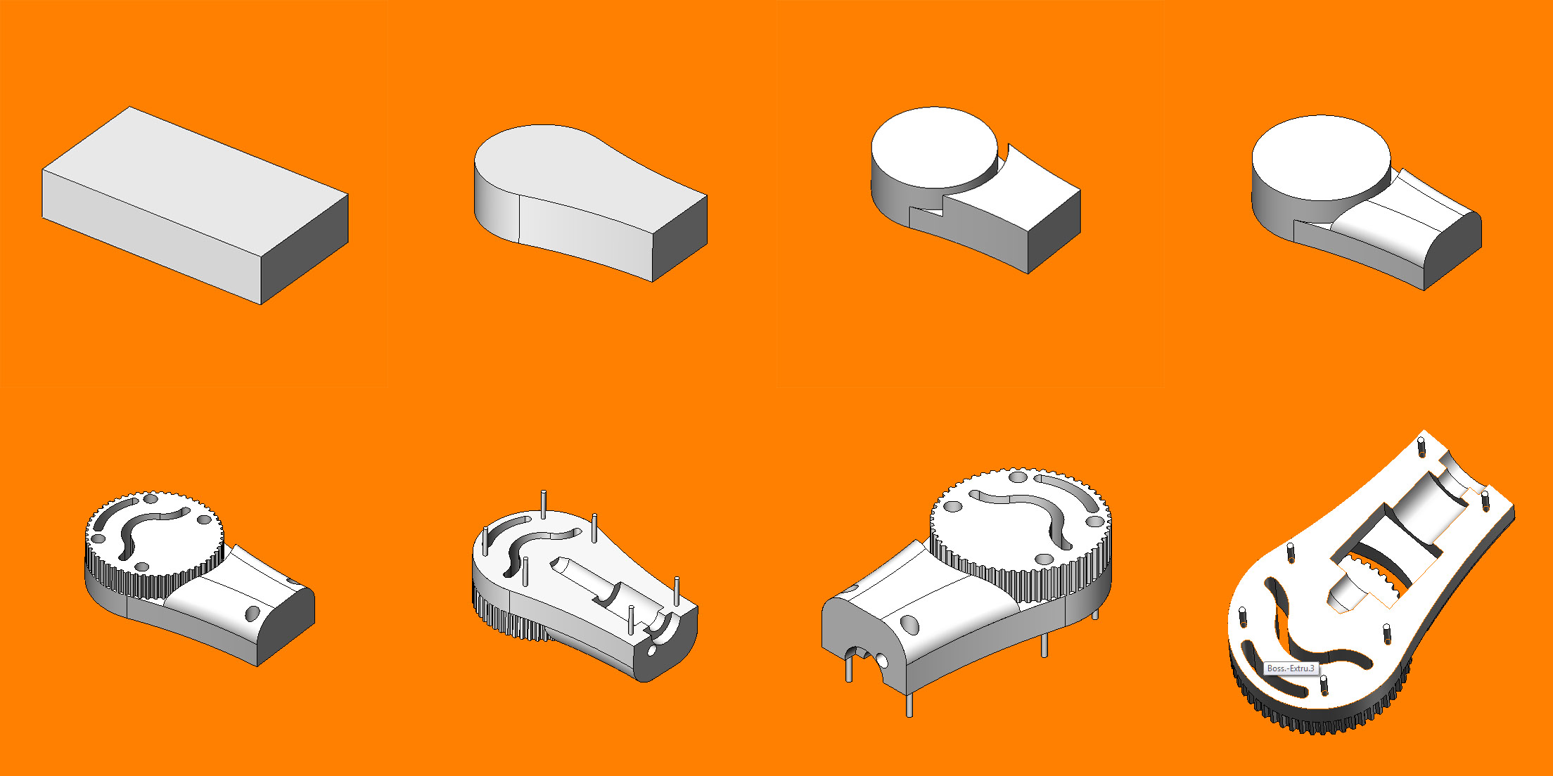

Help on how to start modeling this file ali 14 May, 2017 09:42 PM Any suggestions on where to start when modeling the picture attached (except for the motor in the middle). I am fairly decent modeling "blocky" parts but don't have much experience with "rounded" parts like the one in the picture. forearm_image2.JPG 3 Answers kuldeep sharma Answered on 24 May, 2017 12:14 PM Best method for making objects is removing material means make solid objects then start remove as machine do there process. Richard Barber Answered on 15 May, 2017 06:15 AM Not entirely sure about the underside, but I'd probably start here... large.JPG Roger Couture Answered on 19 May, 2017 07:01 PM The best way is to model the part by designing how it will be machined. ALI forme usinée.jpg
